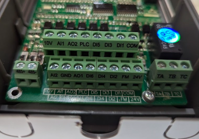

Hi, I am trying to hook up a VFD to my 7i96s. I have a picture of the pinout for the VFD but I am having trouble determining which pins need to attach to the 7i96s and where they should be plugged in.

COM to spin-
AI1 to spinout or Aout
+10V to Spin+
+10V to Spin+
