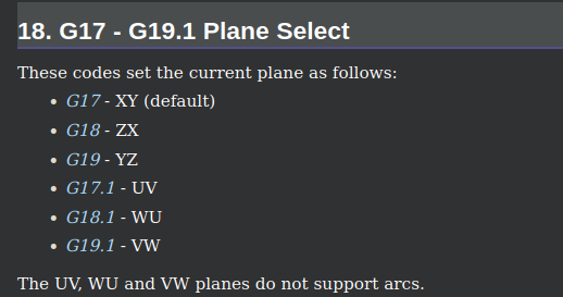

Hi..new here....switching from mach 3...I set up 8 axis so far and want to run a test using my W axis to do an arc ....Should just changing axis name in file fro Z to W work or is there more to it than that?

As far as I know arc moves are only possible in XYZ. Maybe you could describe your setup in more detail as there may be another way to get what you want.
[edit]
linuxcnc.org/docs/html/gcode/g-code.html#gcode:g17-g19.1

Hi..thanks for reply..on a wood lathe I would have rough cut on one side opposed on other with finish cutter...both would need to do arcs but at slightly different times ..also finish cutter acting like skew would have to reverse while rough waits and the both move forward again though offset slightly still. So that is at least two axis on opposing sides sometimes doing arcs simultaneously...finish cutter actually has another axis to rotate cutter to keep bevel angle to wood....would using angular instead of linear work?

It is not possible to execute two arcs simultaneously. What you could do is use the switchable kinematics feature to switch the X and Z axes to different joints. So you could run regular gcode with arcs in the XZ plane and switch in gcode on which side of the work piece the movement takes place. Remember though that this is possible only one after the other not both simultaneously.
Arc moves are really only defined for linear axes XY, XZ or YZ. If you need different linear axes to perform arcs then switching the joint/axes mapping using switchable kinematics seems to be the only way to go.

To add to that, if you are wanting simultaneous synchronized motion of both your roughing and finish heads, you are not going to be able to use arcs at all. You will probably have to use a cam program to output sudo arcs made up of small line segments. This is really the only way to have two heads doing different synchronous movements. You may also need to use G93 inverse time feed commands (especially if you will also be using a rotary axis to control the finish head's angle.)
Imagine each line of g-code as a frame of a movie film, with each new line of g-code as an image of each axis' position at the frame rate's time interval. The difference being, unlike in a film the size of your time interval can be variable. For all linear moves you would only need a frame at the beginning and end. But for anything else the interval can be as small as you need to achieve your desired resolution.
