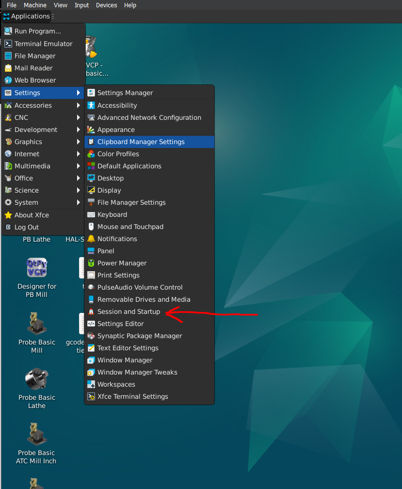

Hello folks,
I am facing a weird problem of blank black desktop after login at my development PC. I think there should be some problem with gnome or ? Have anybody facing same strange behaviour as me too please? Has anybody solution for this situation please? Everything is on right place, folders should be opened but no preview possible...
Thanks for all hint,
regards
regards

Replied by tommylight on topic Blank screen deb12 after login
On power on while booting hold down the shift key till the GRUB menu is shown, press E, add nomodeset before 'quiet splash', press F10 to continue booting.

Replied by zmrdko on topic Blank screen deb12 after login
The following user(s) said Thank You: endian
