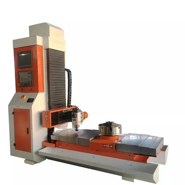

hola.. si, es una maquina de 5 ejes.
la imagen lo baje de internet
- Posts: 21995
- Thank you received: 7488
23 Oct 2024 22:01 #313012
Replied by tommylight on topic KINEMATICS
OK, the machine in your picture has strange axis positions, does yours actual machine have the same position for X Y and Z axis?

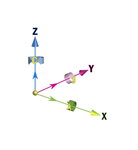

No, I was looking at some models of 5-axis machines and this one seemed interesting to me, so I asked if there was a kinematics for this model.
although this one would be pretty close

There are several 5 axis configurations included with LinuxCNC and they also have VisMach 3D animations so you can see exactly what is moving on screen, with no machine attached, so download the LinuxCNC ISO from here
www.linuxcnc.org/iso/linuxcnc_2.9.3-amd64.hybrid.iso
Use Rufus or Balena Etcher to write it to a USB stick, then boot your PC from it (press F12 or F8 or F11 when booting to show the boot device menu and choose the USB).
In the meu, there is CNC>LinuxCNC and this will show a config picker, so browse through SIM's and start one of the several included configs with 5 axis. Enjoy playing!
This does not install it, it does not delete anything, so when done just remove the USB and use your PC as usual.
