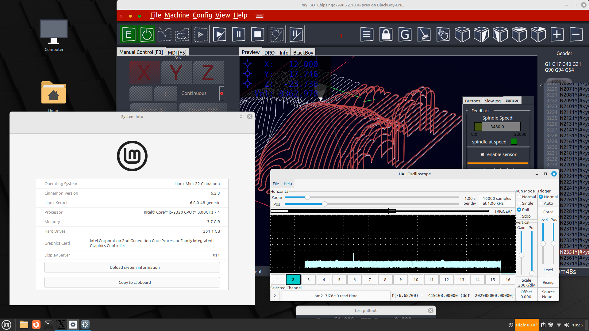

Mint 22 with stock kernel preempt=dynamic works flawlessly with 7i76e was created by zack
cnc@cnc:~$ uname -a
Linux cnc 6.8.0-48-generic #48-Ubuntu SMP PREEMPT_DYNAMIC Fri Sep 27 14:04:52 UTC 2024 x86_64 x86_64 x86_64 GNU/Linux
cnc@cnc:~$ linuxcnc
LINUXCNC - 2.10.0~pre0
cnc@cnc:~$ sudo chrt 99 ping -i .001 -q -c 20000 10.10.10.10
[sudo] password for cnc:
PING 10.10.10.10 (10.10.10.10) 56(84) bytes of data.
--- 10.10.10.10 ping statistics ---
20000 packets transmitted, 20000 received, 0% packet loss, time 20034ms
rtt min/avg/max/mdev = 0.047/0.050/1.014/0.007 ms

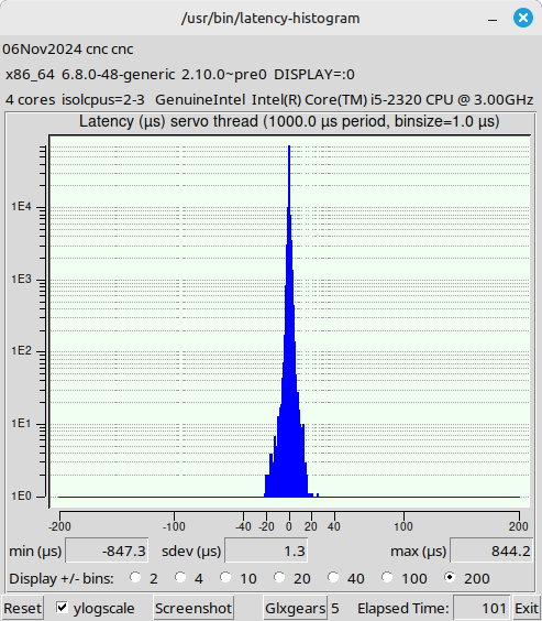

cnc@cnc:~$ latency-histogram --nobase --sbinsize 1000
cnc@cnc:~$ linuxcnc

Replied by zack on topic Mint 22 with stock kernel preempt=dynamic works flawlessly with 7i76e
Yes default, but did do updates and got kernel 6.8.0-48.
A few cmd line params incl isolcpus.
been running on old asus i5 2nd gen for a week now.... no errors.
Thread at 800000.
Funny also realtek nic with stock r8169 driver
seems like we heading to a brighter rt future.
