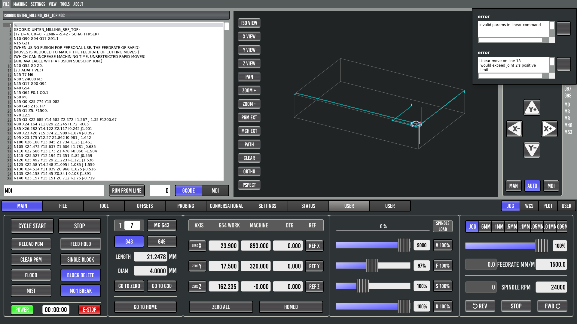

I frequently run into issues like this where I receive the message seen in the screenshot and I am not sure where the problem is. The message points to an issue with Joint 2 (Z-Axis) on a line without Z-Axis command.
My Machine Axis is defined as X=0 at the upper most point XY=0 at the lower left. I referenced the work piece XYZ=0 at the left bottom (XY) on top of my material.
This is the second Tool used on this work piece (first was planing, now it's pocket milling).

I think the linear move causing the error is actually line 19, the G43 Z15 H7. I'm willing to bet your tool length + the 15 in Z is pushing you out of your envelope.

Check in the ini TOOL_CHANGE_POSITION = 0 0 0. The third digit (Z) will be added to the length of the tool and will show the excess.

I found that when using a tool and I mounted it with a tool length of 29.6 mm, I get the error. If I mounted it a bit longer (31.2mm) it works fine! So it seems to be an issue with the maximum height although it is far from reaching it (?). Strange.
I’ll try the definition you mentioned above and try again. I am using probe basic if this makes any difference.

This setting gives an error, when going G0 G53 Z0, because max limit reached
Its better to have MAX_LIMIT = 0.1
MAX_LIMIT = 0
