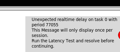

I am getting this error now.
Actually I have been getting this error all the time.

Is that base period or servo period?
In the ini file, do not change the value of servo period, it should be 1000000 (1 million).

sorry Tommy I have been side tracked all month. I will change the base back to 1million and give it try.
