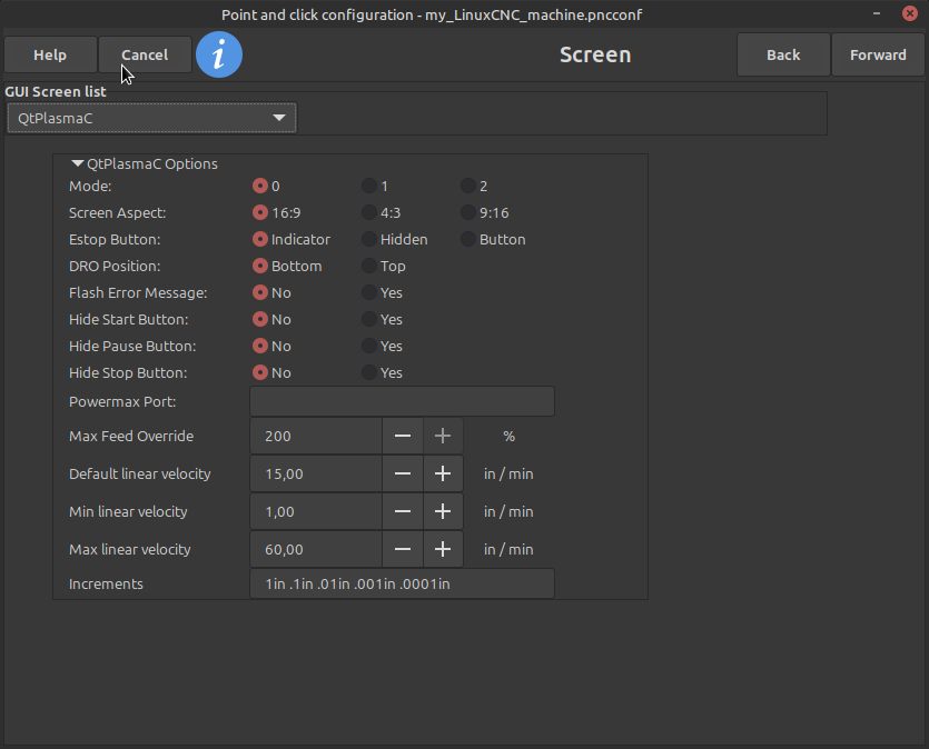

The other part I always mess up is after installing.
so I’m going to config a machine with 7i76eu + thcad-2 (I think, whatever model the currently have). So I need to configure the system with plasmac
i alway alway forget how to set plasmac on the system.

If you forget something, you can use the wizard to edit that same config, or just make another one, you can have as much config as you like.

Okay, is qtplasmac built in to the basic config wizard now? Or do I have to download it or upload something for it?
