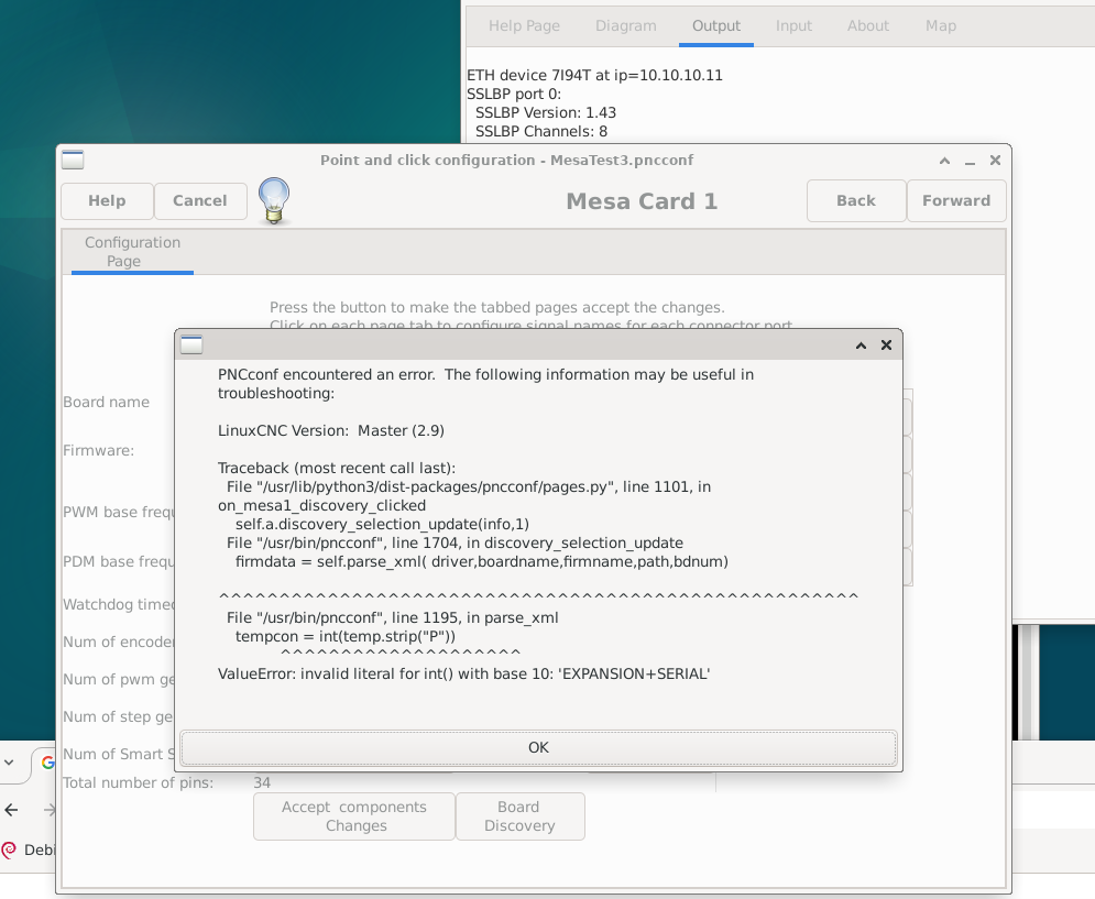

- wrhammer
- Posts: 13
24 Nov 2024 22:30 #315217
by wrhammer
Replied by wrhammer on topic Multiple Mesa 7I84 I/O board setup
- wrhammer
- Posts: 13
25 Nov 2024 21:43 #315271
by wrhammer

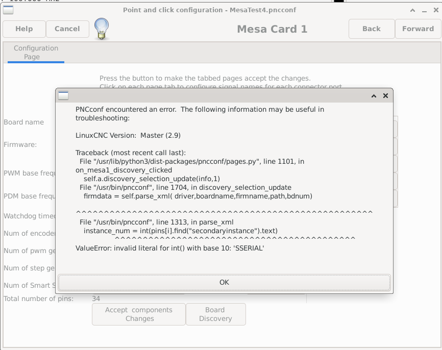

It looks like it's something with the pin file maybe when I try and choose Mesa Card 1. I did the mesaflash --readhmid and copied that to the PnCconf Input, removed the Expansion from the line: IO Connections for Expansion Serial 0..1 -> 7I94_0 and now I get a VauleError: invalid literal for int() with base 10: 'SSERIAL'
Is there something I'm missing? I did a compare of the successful 7I96S pin file and didn't spot any discrepancies.
Attached is a screenshot of the error and a text file of the 7I94T --readhmid
