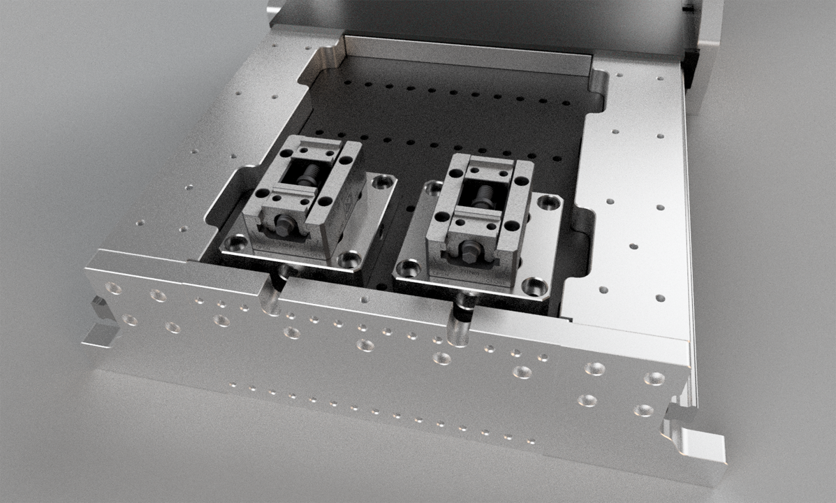

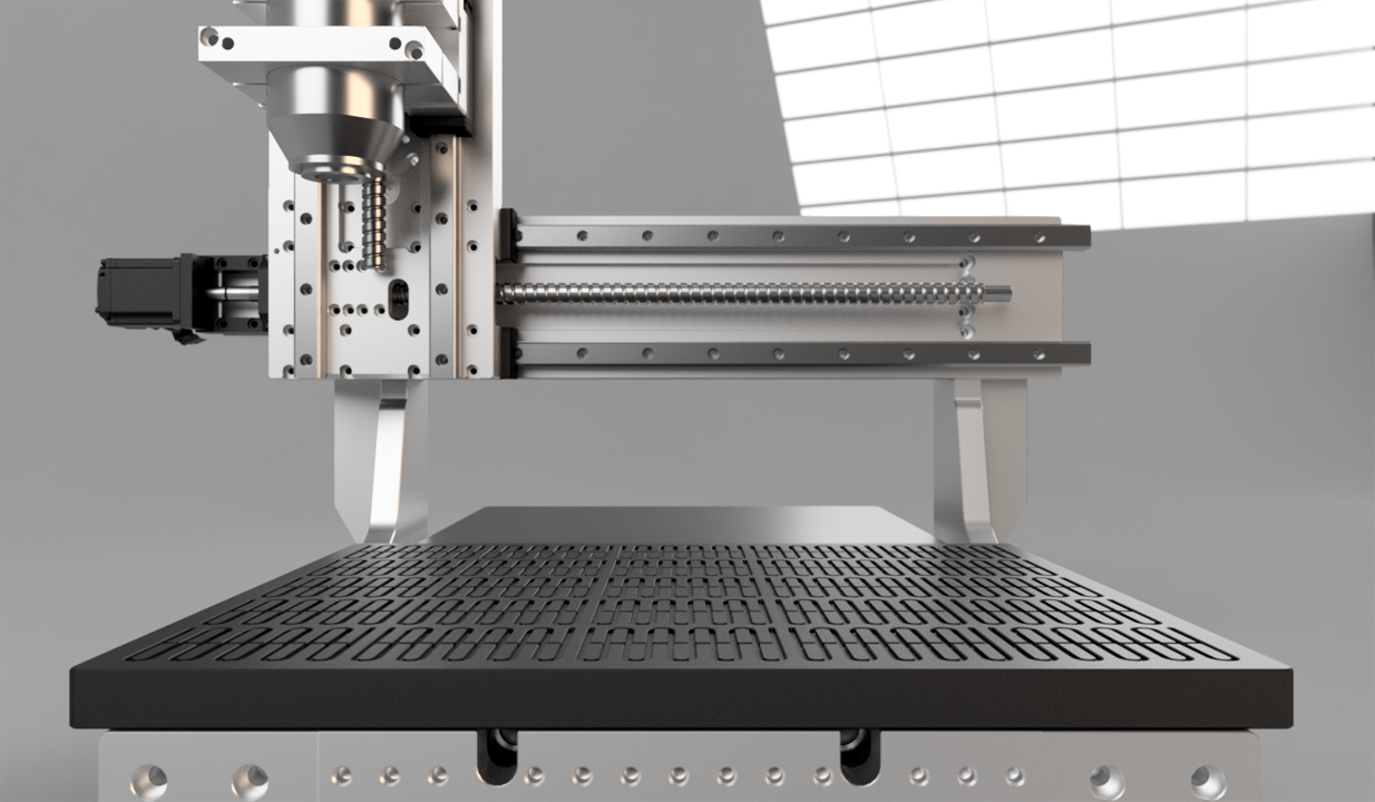

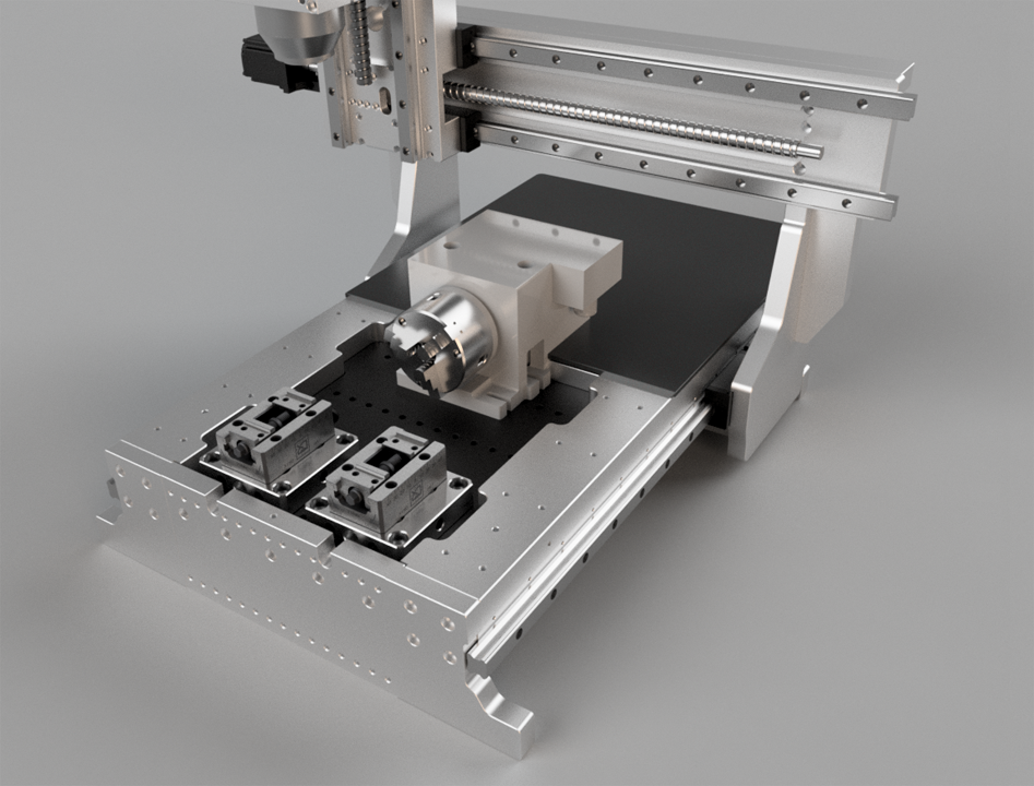

Working on my larger machine and based on the work I'm gonna use it for, being able to probe a part or work piece and then have the machine not just offset but also rotate the coords would be nice. For clarity, I want to stick stock down and if that stock happens to be 12 degrees out of square the probe will measure and then rotate the program to match the stock. (12 degrees is extreme of course, but it gets the point across).I understand linuxcnc *can* rotate coords, but beyond that I know nothing on the topic. Has anyone made use of this? How does it work?
