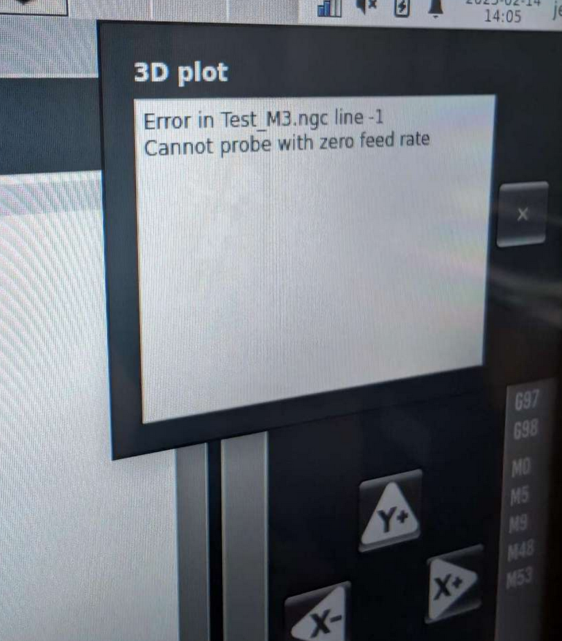

Hello,
I am a fairly new LinuxCNC User. I am using a Mesa 7i76e with the probe basic UI.
So far everything works fine but I am having one "issue" or inconvenience.
Whenever I load a gcode, I get the following message: (Header) 3d plot (message) Error in ...ngc line -1 Cannot Probe with zero feedrate.
It still works, I can start the gcode and it runs without any issues but I would like to know why this message comes up.
I will attach my config files and a pic of the error as well as the gcode that was loaded when I took that picture.
If someone knows where this is coming from, please share your wisdom!
Thanks in advance!

Your issue seems to come from your custom mcodes (M300, M500, M600).
Generally we don't want to have toolchange related stuff run on gcode load and the way to make sure it isn't is to check the 'task' parameter which returns 0 on load and 1 during actual gcode execution:
o100 if [#<_task> EQ 1]
;everything in here is only executed during actual gcode execution
o100 endifPlease Log in or Create an account to join the conversation.

The M600 calls this macro: github.com/TooTall18T/tool_length_probe/...n/tool_touch_off.ngc
As this macro uses the "normal" M6, I remapped M6 to my own macro "manuell_atc" (github.com/GameOEver/LinuxCNC/blob/main/manuell_atc.ngc).
M300 and M500 basically add an M64Px to M3/M5 to have a vavle for the ATC spindle turn on and off for the air seal.
I am currently working on an ATC carousel, but it will probably take a few months to get it working. In the meantime I have made a very simple macro that basically turns valves on and off when you press cycle start for release or clamping tools.
If I understand your comment correctly, I would only call my "manuell_atc" macro when #<_task> EQ 1?

The issue is caused by the part with the g38 command as that is where the error message comes from. So you would only call 'tool_touch_off.ngc' when #<_task> EQ 1

You can try to add this to my routine.
I don't know if this make a different, because I only get the messages of zero feed rates if I set "fast probe fr" or "traverse fr" to "0".
o<tool_touch_off> sub <-- search for and add this below:
o<400> if [#<_task> EQ 1]
(LOGCLOSE)
o<400> endif
o<tool_touch_off> endsub <-- search for and add the line above

That fixed the message popping up, thanks!
