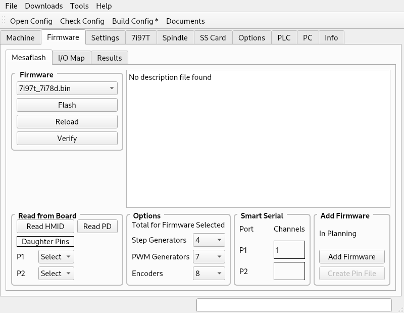

Hey guys,
it's been a while since my last post.
I am currently working on retrofitting a DMG 50 with analog +-10V Simodrives.
The Mesa's for this project are already laying on my desktop.
I am coming from 7i92 + 7i77, so many tutorials for these builds. Now with the 7i97T i am kinda lost when it comes to flashing.
I need a bin file for the combination :
7i97T
7i84 - over TB4 (ethernet)
7i78 - over P2
Can anyone bring some light into this? Or already used this combination?
The 7i78 is "only" for backup if more encoders are needed- so maybe I can start the config without it.
Thanks in advance for any help guys
BR Joel

The smart serial card does not need firmware. The 7i97t_7i78d.bin firmware is what you want and you can flash it with the
Mesa Configuration Tool
JT
JT

Hey JT,
thanks mate! I finally got it "running".
I will try some things tomorrow. What do I have to modify in the HAL to accept the 7i78? Or is it working already?
Thanks!!
