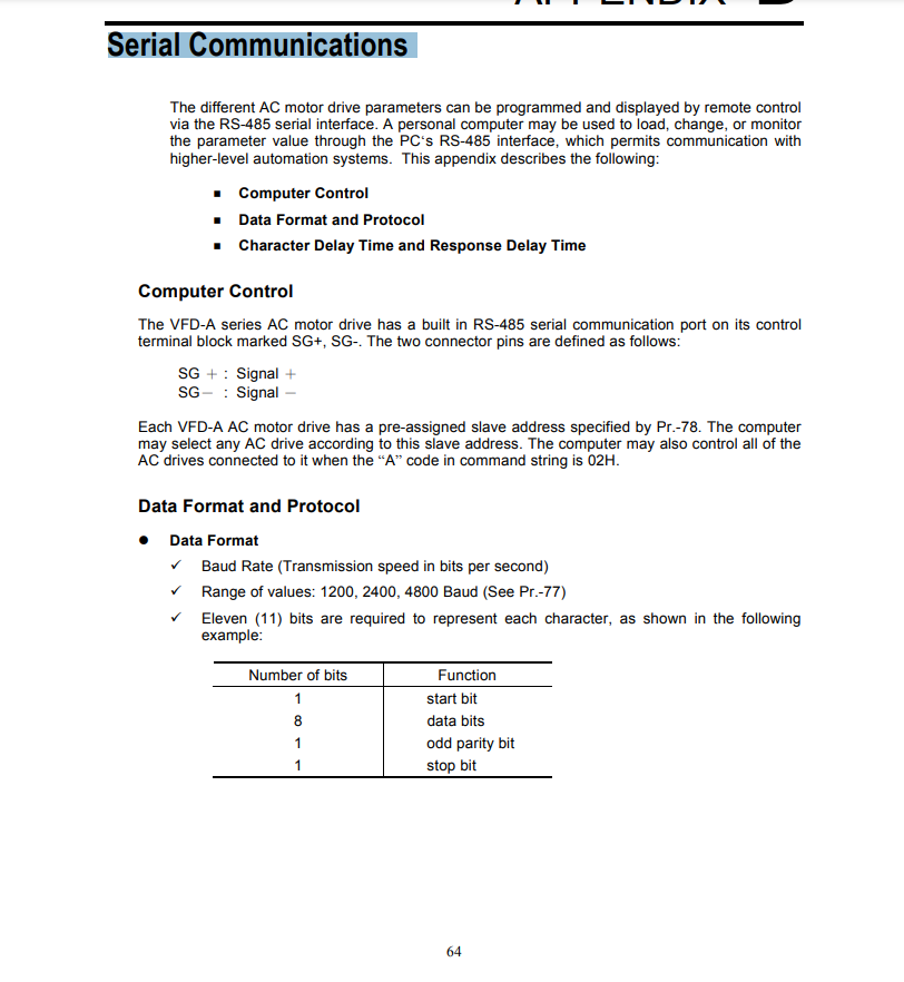

Hello,
i have a delta VFD-H, i have checked the manual there is no mention of modbus, only Serial Communications rs485 is mentioned, can i still use it with linuxcnc over rs485 ?
28 Feb 2025 13:37 #322867 by tommylight
Replied by tommylight on topic VFD RS485
Why was this deleted?
28 Feb 2025 20:21 #322885 by Khan
Replied by Khan on topic VFD RS485
hello, for some reason delta put a sticker on for their high frequency drive VFD-H, i removed the sticker and it was actually a B drive VFD-B and i checked the manual it does support modbus,
