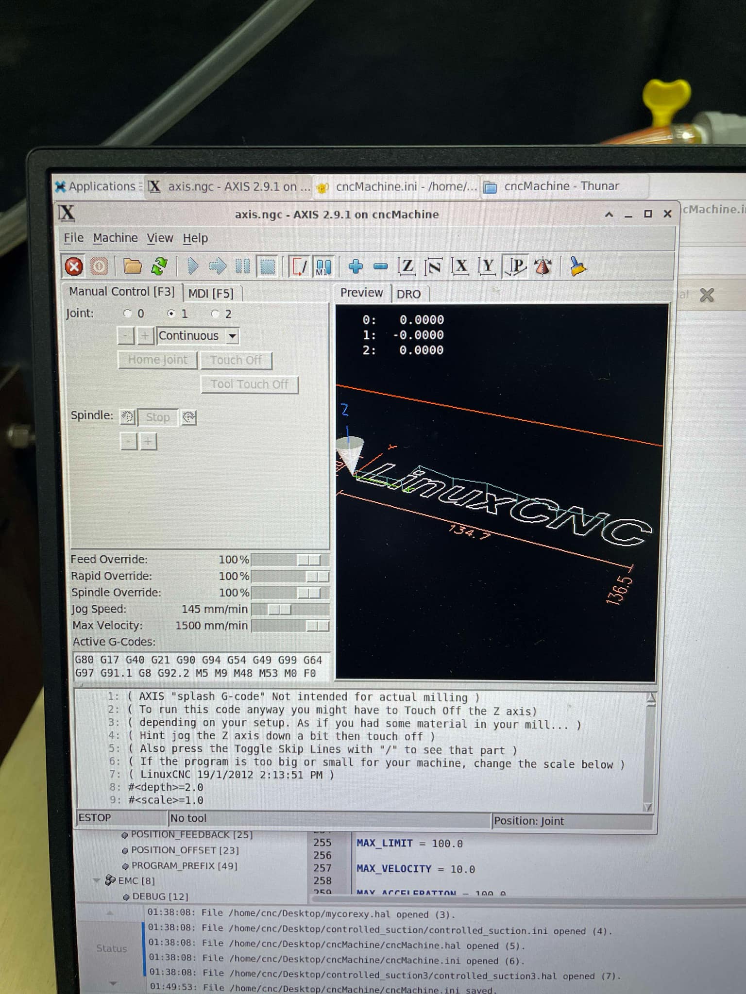

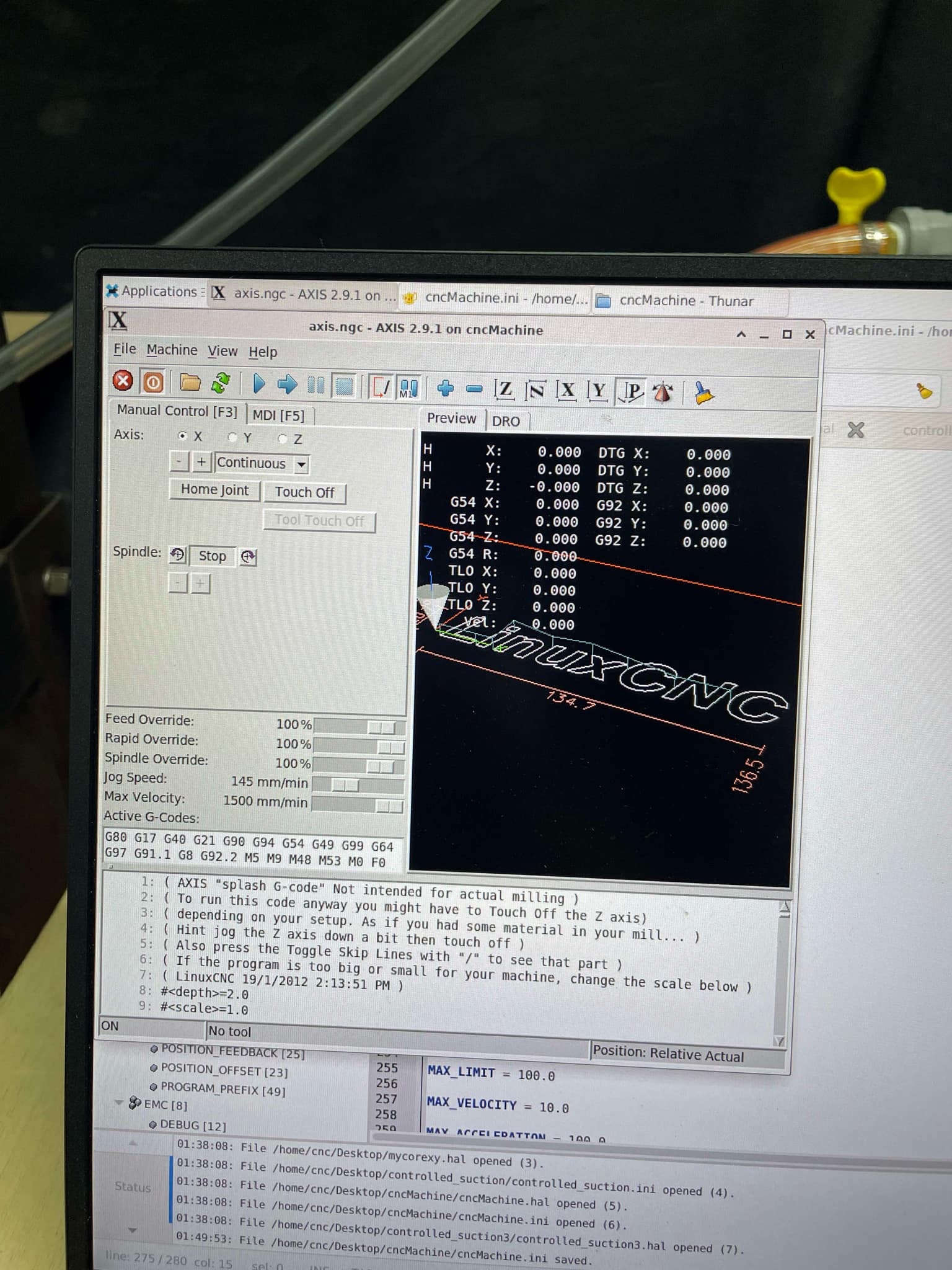

I am using byte2bot, and my XY axes are based on a CoreXY system.Right now, I’m trying to use homing, but when I enter the system, I can only use the XY axis after the joints are homed. However, I am unable to home both joints at the same time.Is there a way to skip joint homing and directly enter the XY system, then perform homing from there?
Like the attached picture.

Is that a CoreXY machine?
If not, remove that line in the ini file and use the line above it.

Yes, it is a CoreXY machine.

Working config attached
The following user(s) said Thank You: rodw, Chia
