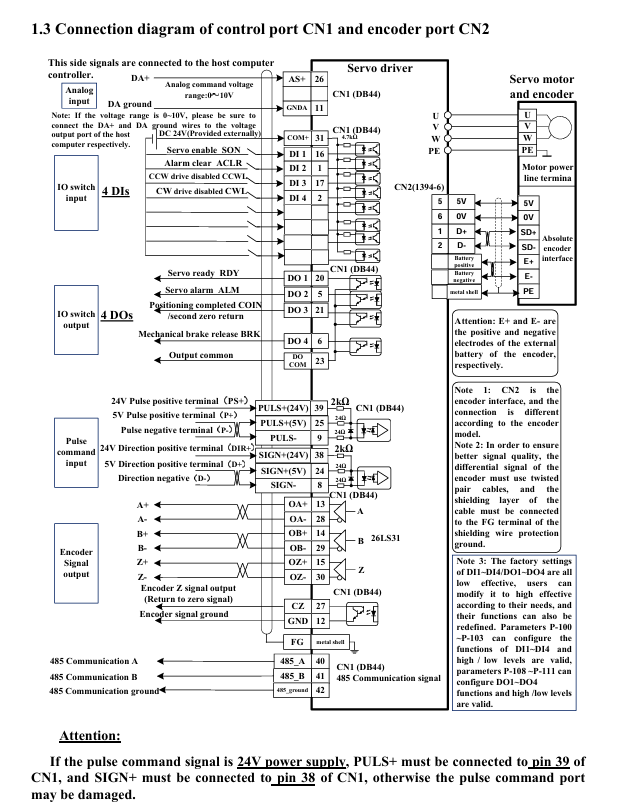

connections for 7i97t
- dlc mnl
- Posts: 16
11 Mar 2025 00:56 - 11 Mar 2025 00:59 #323644
by dlc mnl
connections for 7i97t was created by dlc mnl
Last edit: 11 Mar 2025 00:59 by dlc mnl. Reason: error of image
- Posts: 18111
- Thank you received: 5330
11 Mar 2025 01:39 #323647
Replied by PCW on topic connections for 7i97t
7I97T DRIVE CN1
AOUTN AS+ (26)
GND GNDA (11)
ENAN+ SON DI1 (16)
ENAN- 24V Common
INN RDY DO1 (20)
INCOM +24V (Drive output common 24V common)
QAN+ OA+ (13)
QAN- OA- (28)
QBN+ OB+ (14)
QBN- OB- (29)
QIDXN+ OZ+ (15)
QIDXN- OZ- (30)
AOUTN AS+ (26)
GND GNDA (11)
ENAN+ SON DI1 (16)
ENAN- 24V Common
INN RDY DO1 (20)
QAN+ OA+ (13)
QAN- OA- (28)
QBN+ OB+ (14)
QBN- OB- (29)
QIDXN+ OZ+ (15)
QIDXN- OZ- (30)

Is z encoder output signal and encoded signal to ground needed?
- Posts: 18111
11 Mar 2025 21:54 #323709
The "Z" signals are needed if you want to home to index.
(for more accurate homing)
Yes, normally you would connect the encoder ground at both the
drive and 7I97T end.

Is rdy needed?

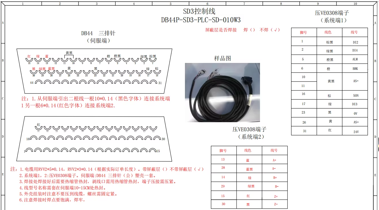

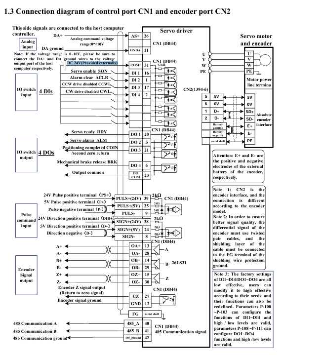

Hello, what connections are needed for the 7i97t?
I have this spreadsheet, and these are the connectors.
has no rdy
has no rdy
- dlc mnl
- Posts: 16
17 Apr 2025 23:41 #326552
by dlc mnl
Replied by dlc mnl on topic connections for 7i97t
15 oz+
14 ob+
13 oa+
11 da ground gnda
10 as-
6 brk
5 alm
2 drive disabled cwl
1 aclr
30 oz-
29 ob-
28 oa-
26 as+
23 do com
17 drive disabled ccwl
16 son
31 com+
14 ob+
13 oa+
11 da ground gnda
10 as-
6 brk
5 alm
1 aclr
30 oz-
29 ob-
28 oa-
26 as+
23 do com
16 son
31 com+

20 rdy missing?
