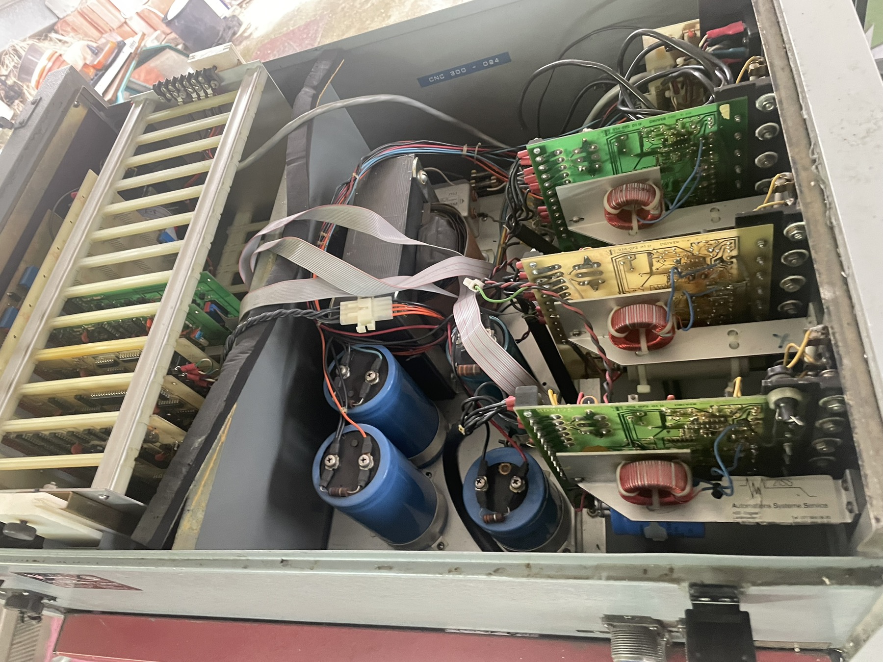

that I know that the drivers are not expensive, or in that case I would have to install other motors, because there is no driver for such motors with an unknown type and with 8 wires.

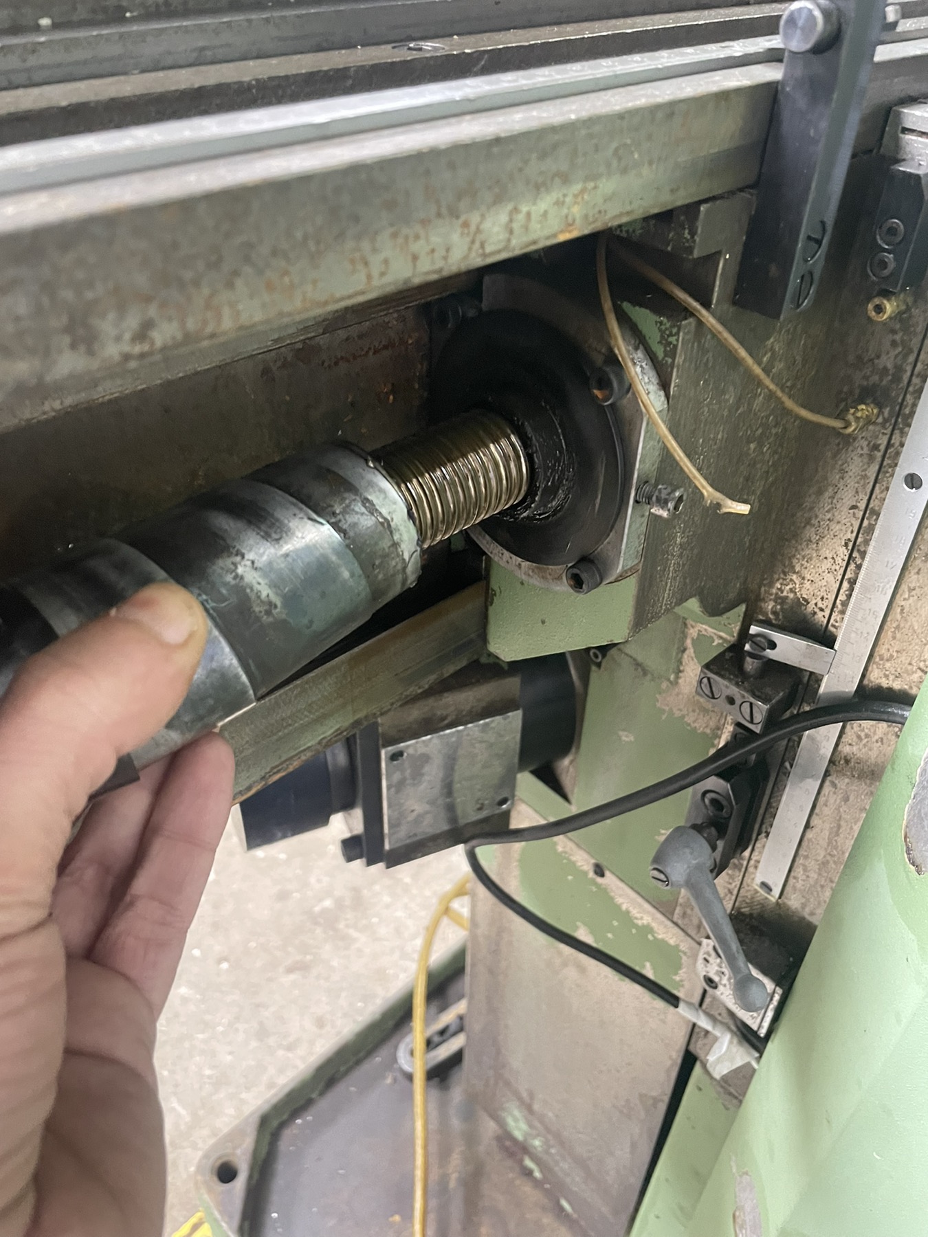

26 Mar 2025 15:50 #324980
by Masiwood123
Replied by Masiwood123 on topic bandit controller retrofit
that's right, on my market you can find a cheap servo set from 1 kw motor + driver for 200 euros., I have to check first if it has backlash , I mean ballscrews

thank you very much for the answer, but I really don't understand how to check it, I only know in the case when drivers , old amps` are appeared with an analog input +-10v. Yes ,that this is probably a signal ribbon cable from controller board to driver.

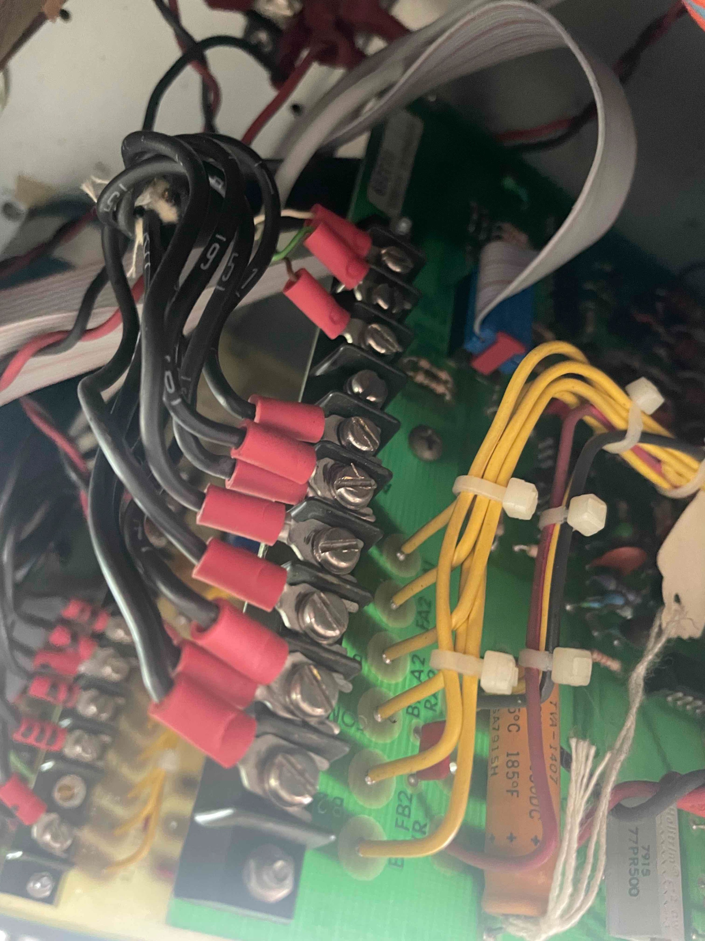

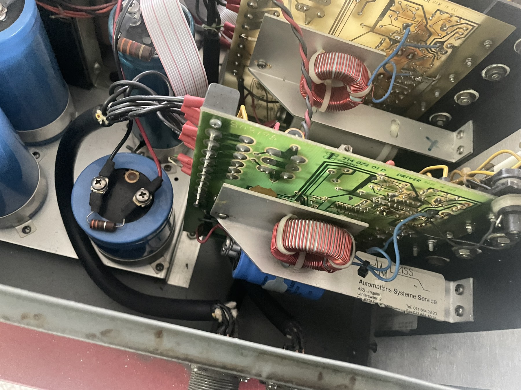

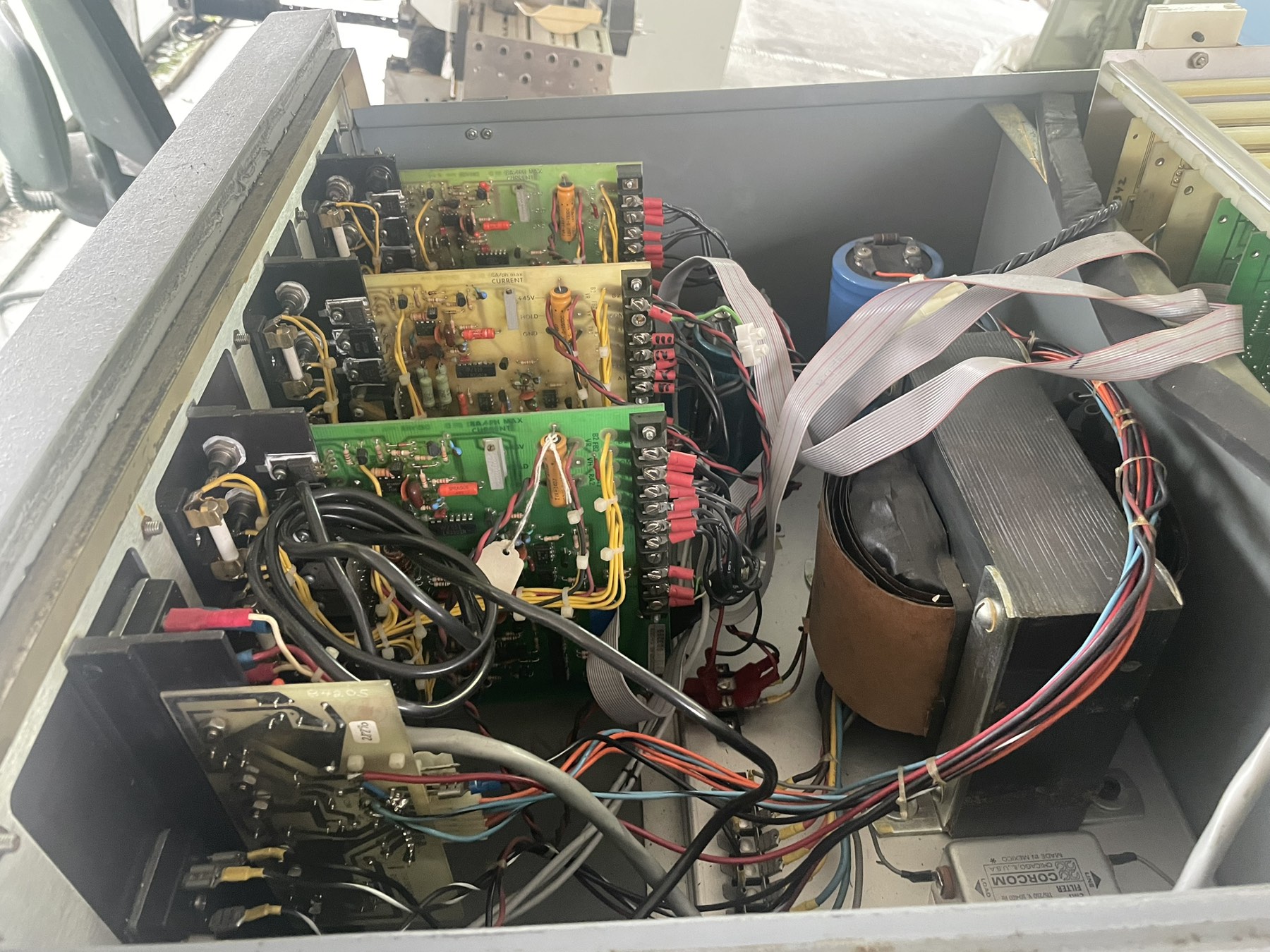

27 Mar 2025 21:27 #325107
Replied by PCW on topic bandit controller retrofit
Those are step motor drives, 8A max
No idea how they are interfaced but
maybe worth a bit more searching with
the drive PN:
214 072 01d
the drive PN:
214 072 01d
- Posts: 18111
- Thank you received: 5330
27 Mar 2025 22:45 #325119
Here's a thread of someone else doing a similar retrofit:
www.cnczone.com/forums/uncategorised-met...253-engineering.html
The existing drives are 2 phase, unipolar, and 8A
(Unipolar is why they have 6 motor wires because each winding has a center tap)
I think the forum suggestion is good: Replace the drives with standard bipolar
stepper drives but since the windings are wired in series for a bipolar connection,
use the highest voltage capable drive you can get.
(this assumes you want to keep the motors)

28 Mar 2025 00:09 #325127
They are 2 winding type, that's not in question.
There are 6 connections because unipolar drives need
windings with a center-tap. You would ignore the center tap
when using a bipolar drive (series connection).
Note that when using this series connection you would
lower the drive current (so say 4 A instead of 8A)

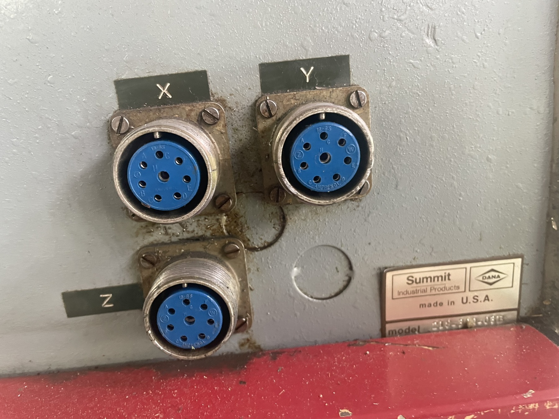

28 Mar 2025 19:46 #325183
by Masiwood123
thank you guys, you helped me a lot, I realized that these are in fact stepper drivers and motors, the voltage is 45vdc, I will buy a simple stepper driver and try to connect phases a,a+,b,b+ and according to my understanding ``com'' I should short-circuit two pairs (wires) of aCOM and bCOM separately

28 Mar 2025 20:06 - 28 Mar 2025 20:07 #325188
Replied by tommylight on topic bandit controller retrofit
Do NOT use the COM motor wires on new drives!!!
Do NOT use 5 wire stepper motors with new drives!!!
New drives are always "bipolar" meaning each winding has it's own H-bridge.
Old drives were "unipolar" meaning each winding was driven by a single transistor/MOSFET to ground, while all 4 pins from one side of all 4 windings was wired to + (positive) of the power supply.
Use a DVM in OHM or BEEP mode to find out what wires belong to the same winding, and based on resistance you can also figure out the middle wire, see bellow:
-if you want max torque but lower rotation speed, use the two wires with most resistance, in your case use A1/A2 and B1/B2 and leave ACOM/BCOM unconnected. Do isolate them so they do not touch.
-if you want more speed at lower torque, use the middle wire and 1 of the remaining 2 wires, it does not matter which one, just one.
