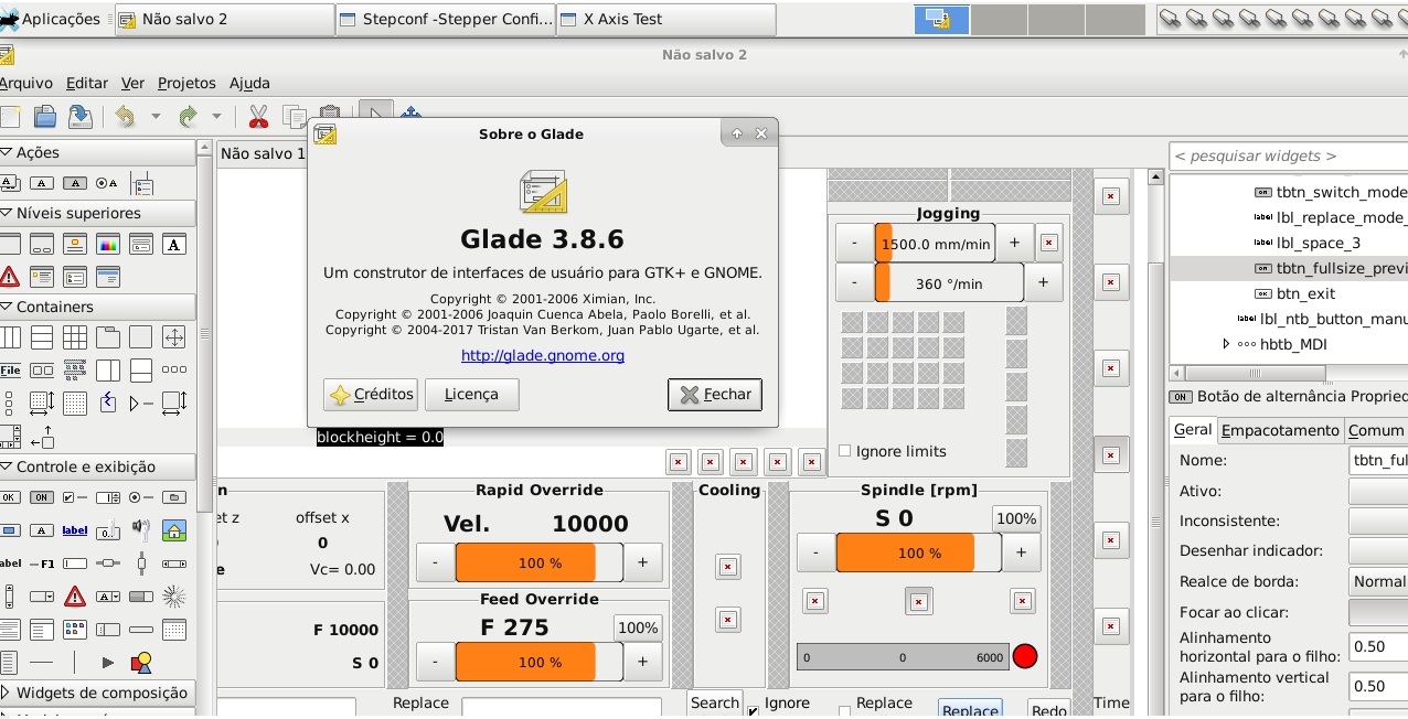

hello, i'm new to linuxcnc and i'm looking for how to add a button in the gui (qtdragon preferably) and drive an output with it. can you help me please? i didn't find any examples on the linuxcnc site and the explanations aren't clear to me.

27 Mar 2025 19:52 #325097
by programador
Replied by programador on topic custom button
- Posts: 7368
- Thank you received: 2181
28 Mar 2025 02:00 - 28 Mar 2025 02:08 #325131
Replied by cmorley on topic custom button
Qtdragon uses Qt so glade is not so useful, it would require QtDesigner.
There is a button to turn a laser on and off that is included in QtDragon.
The button is on the offsets tab. the pin is qtdragon.btn-laser-on
If that is not what you want there are more options, such as macro buttons.
Customizing the screen layout with extra buttons is not super hard - where would you want the button?

OK, thanks. I'll give it a try. I'd like to add a button instead of macro buttons in qtdragon. thanks in advance.
