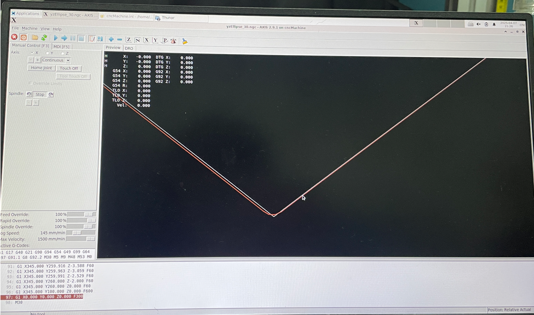

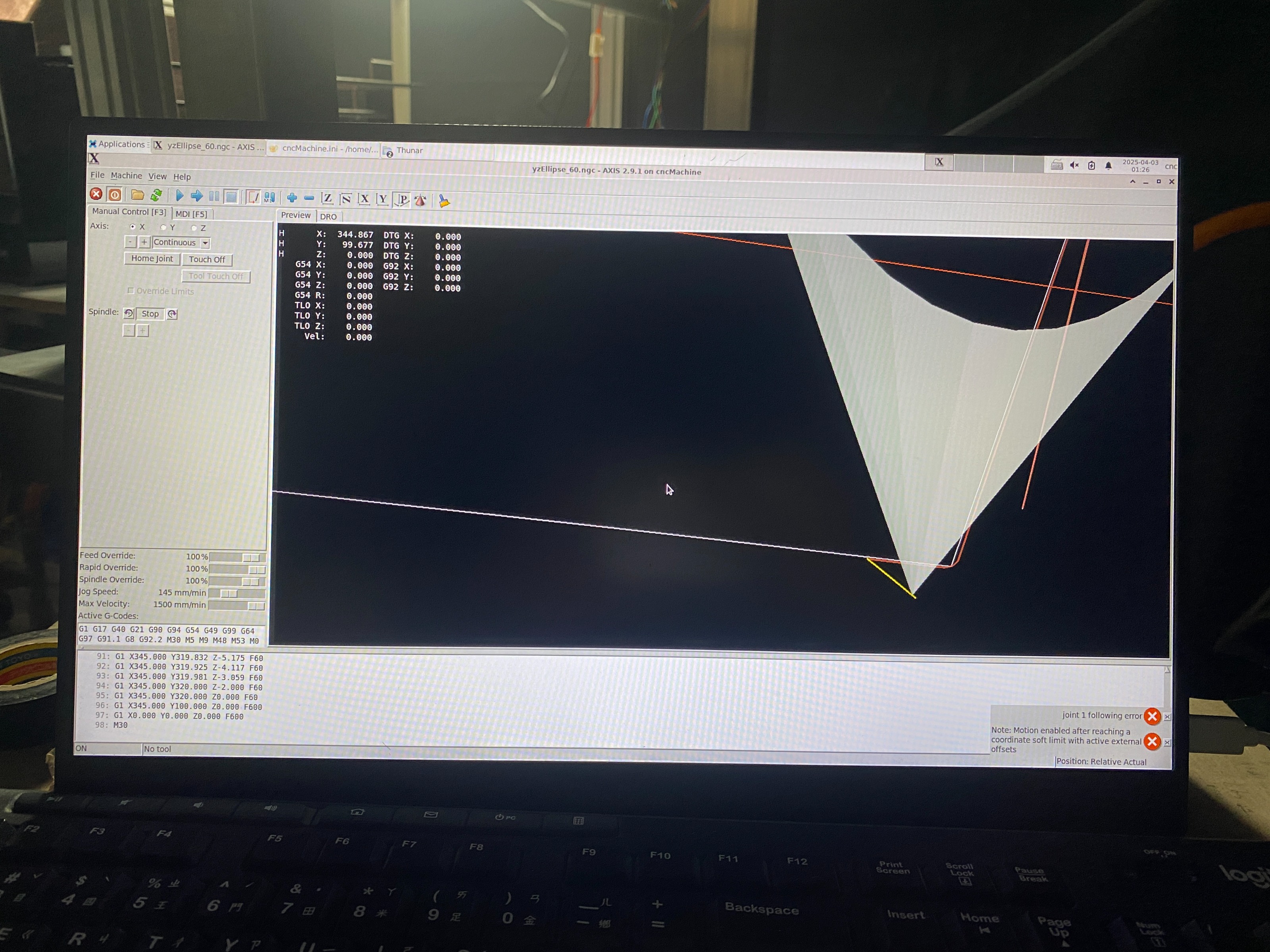

My machine uses a CoreXY system for the XY axis and a linear system for the Z axis.
When I run yzEllipse_60.ngc, the machine stops and reports an error when returning to the home position.(IMG_7058.JPG)
The same issue occurs when running yzEllipse_50.ngc (IMG_7058.JPG).

Sorry, the error picture of yzEllipse_50.ngc is IMG_6981.JPG not IMG_7058.JPG.

During testing, I tried using microstepping at 8, and I changed the scale in the ini file to 40. Then I set G-code "97: G1 X0 Y0 Z0 F300", and it ran successfully!
However, I don't understand why G-code "96: G1 X345 Y100 Z0 F600", runs properly with F600, but when I use G-code "97: G1 X0 Y0 Z0 F600", it fails to run. Why does line 96 run successfully with F600, but line 97 produces an error even though both use F600? Could you please help clarify this difference? Thank you.
It likely depends on the maximum velocity reached, (which is acceleration and GCODE dependent)
at some point the stepgen component cannot generate steps fast enough at the current base
thread period so falls behind, causing a following error.
