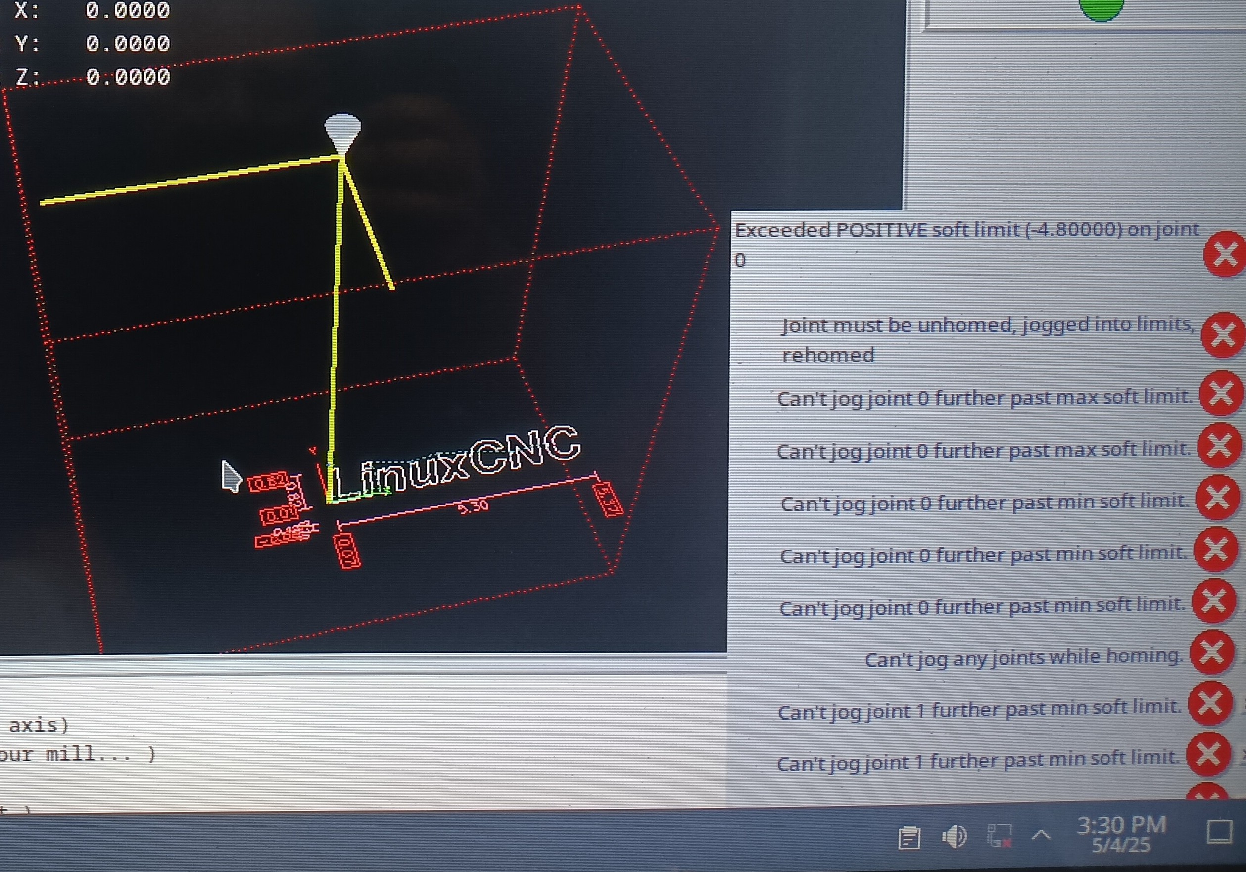

soft limit error after x homing, does not home y was created by Micro2000
I keep getting a soft max and min limit after homing x and stops the homing all process, after homing it gives "Exceeded POSITIVE soft limit (4.80000) on joint 0" i can neither move x or y axis, can move z axis, I can home y axis, but then I cant move z axis after that.I have the axis version of linuxcnc 2.9.0 on plasma KDE desktop.

Replied by PCW on topic soft limit error after x homing, does not home y
Looks like your min and max limits on X and Y (and joints 0,1) are reversed.

- Micro2000
- Posts: 35
05 May 2025 22:13 - 05 May 2025 22:14 #327795
by Micro2000
Replied by Micro2000 on topic soft limit error after x homing, does not home y
it does not change, it still homes in the same direction. only flipping the positive and negative in the table length changes the direction.

06 May 2025 05:13 #327828
If the homing direct does not change, then it's likely the you did not
change the correct ini constant (or perhaps there is another error in
the ini file homing constants or perhaps home switch operation)
I don't think you can eliminate the soft limits issue unless you get the
MIN_LIMIT and MAX_LIMIT setup properly (MIN_LIMIT < MAX_LIMIT)
It may also be the you have the hardware directions reversed, this you can
fix by inverting the direction pin or changing the sign of the joint SCALE
ini constant. (say 4000 to -4000)

- Posts: 18111
- Thank you received: 5330
06 May 2025 20:44 #327887
#*** AXIS_X *******************************
[AXIS_X]
MAX_VELOCITY = 0.5
MAX_ACCELERATION = 0.2
MIN_LIMIT = 4.8
MAX_LIMIT = -4.8
[JOINT_0]
TYPE = LINEAR
HOME = 0.0
MIN_LIMIT = 4.8
MAX_LIMIT = -4.8
MAX_VELOCITY = 0.5
STEPGEN_MAXACCEL = 0.25
SCALE = 4000.0
FERROR = 0.05
MIN_FERROR = 0.01
HOME_OFFSET = -4.500000
HOME_SEARCH_VEL = 0.100000
HOME_LATCH_VEL = -0.100000
HOME_IGNORE_LIMITS = YES
HOME_SEQUENCE = 1
[AXIS_X]
MAX_VELOCITY = 0.5
MIN_LIMIT = 4.8
MAX_LIMIT = -4.8
[JOINT_0]
TYPE = LINEAR
HOME = 0.0
MIN_LIMIT = 4.8
MAX_LIMIT = -4.8
MAX_VELOCITY = 0.5
SCALE = 4000.0
FERROR = 0.05
MIN_FERROR = 0.01
HOME_SEQUENCE = 1
