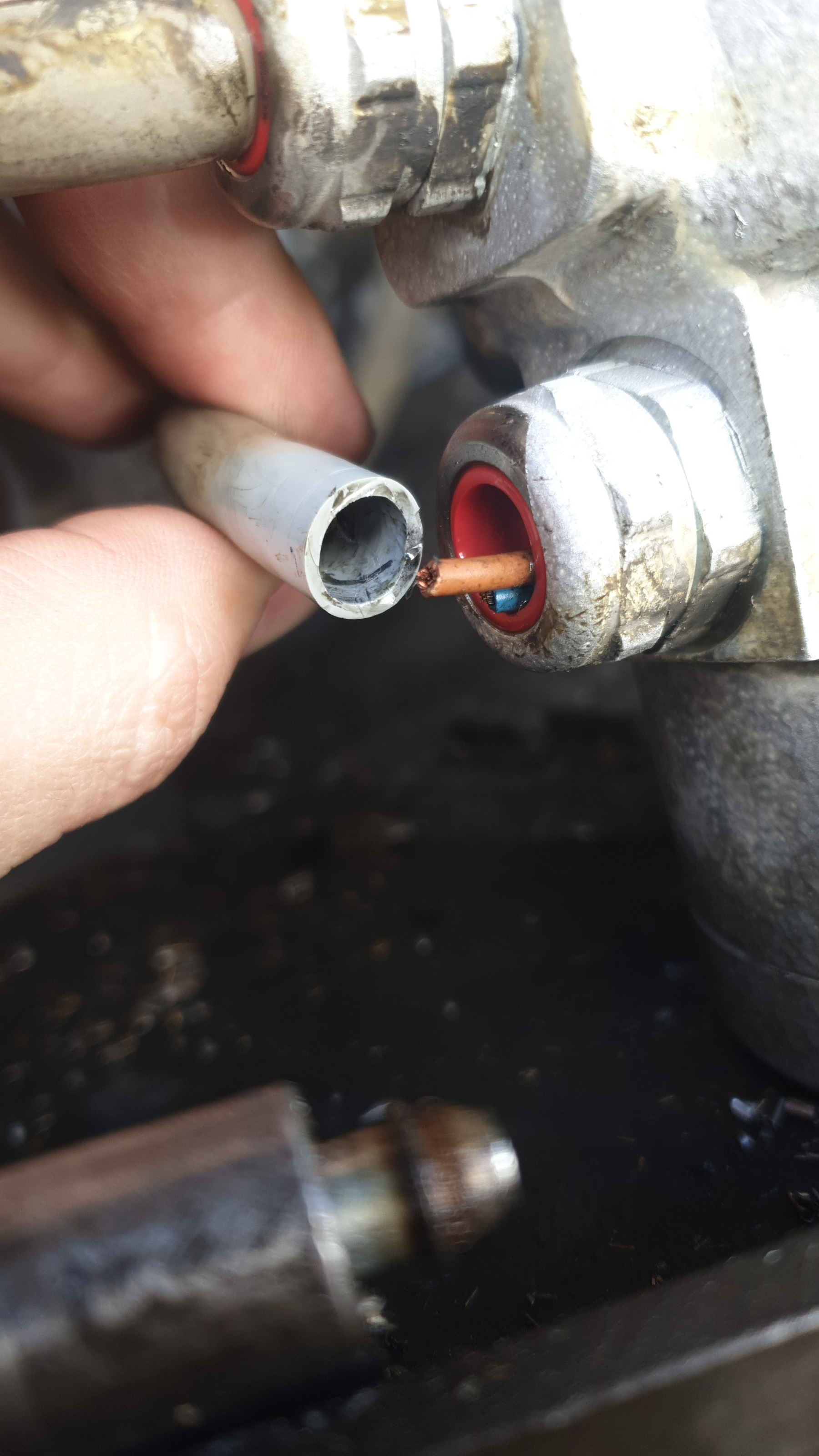

UPDATE:
After i stopped the servo from spinning on it´s own I went on to setup the limits and the X-Axis ran away like carzy, you´d give 0,05V on to the servo drive and it would react with max speed. I was confused since everything worked fine with 0,02V.
From the other axis i knew it should behave diffrent and should have a slow smooth motion with 0,5V
I´ve swapped the drives with each other, same
I´ve swapped the driver with a new one, same
I´ve checked the wiring, everything on the correct terminal.
I´ve checked the Tacho signal: 0V - THATS IT. The servodrive trys to keep up with the command, but since the Servo isn´t moving it gives even more power until it goes into fault or the axis crashes.
So i was sure the servo is cooked. I was already checking the sister machine for a spare Servo, already loosening the screws and was kinda like:
"oh let´s first remove the broken one".
As i pulled the cables i noticed the cable to the Tacho was ripped out INSIDE the screw thingy where the cable enters the housing. I repaired the wiring and voilá, servo works as expected.
So long story short, the previous owner already had the ripped wire and tried to fix it with tuning the drive, just like i did. The real problem was the severed cable to the tacho.
