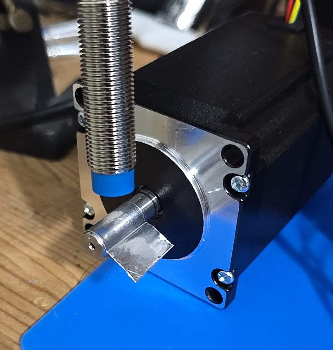

I am try homing and limits.For test i have only Y stepper driver installed.
Homing work.
but i limit stop not work. I need for safety and bad moves.
hal:
ini:
I read:
forum.linuxcnc.org/38-general-linuxcnc-q...tches-is-it-possible
forum.linuxcnc.org/38-general-linuxcnc-q...ng-on-a-single-input
www.forum.linuxcnc.org/49-basic-configur...sibly-wrong?start=60
forum.linuxcnc.org/plasmac/46160-homing-...ctive-before-backoff
linuxcnc.org/docs/devel/html/config/ini-homing.html
what do i need to do to make the limits work?
Why doesn't homing lock the stepper instantly and needs a monstrously slow motion for the initial search?
Homing work.

added ini:
added hal:Work!
I still need to figure out why the home search has to be done so slowly.
HOME_IGNORE_LIMITS = Trueadded hal:
net Y_HOME remora.input.09 => joint.1.home-sw-in joint.1.neg-lim-sw-inI still need to figure out why the home search has to be done so slowly.

In the ini file
HOME_SEARCH_VELOCITY
HOME_LATCH_VELOCITY
HOME_FINAL_VELOCITY
Any of those you have, set to some reasonable value in machine units per second.
