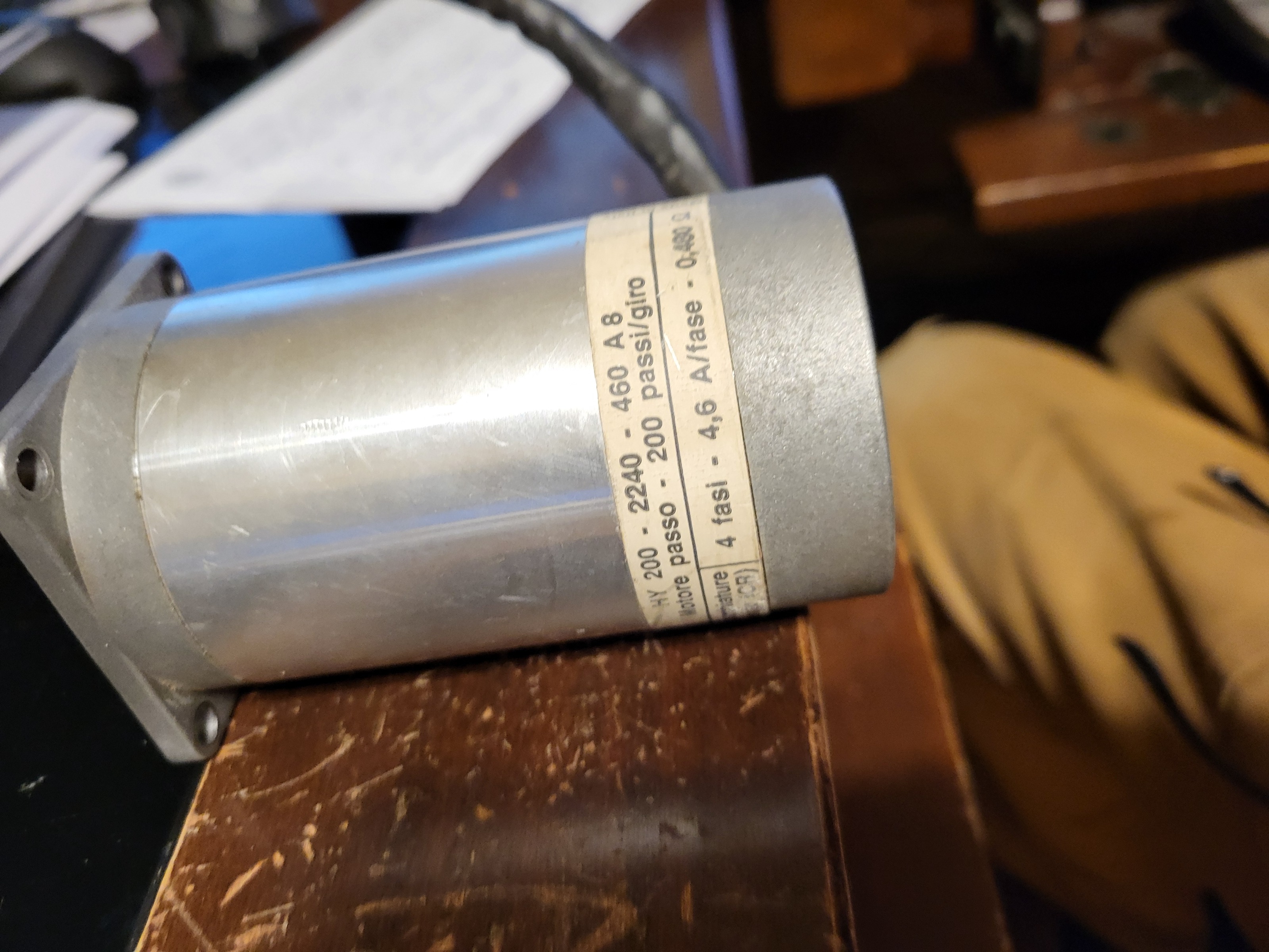

- jimboh2
- Posts: 11
12 May 2025 23:46 #328330
by jimboh2
Replied by jimboh2 on topic Linuxcnc wood lathe insufficient torque
Pic attached
- Posts: 21995
- Thank you received: 7488
13 May 2025 02:00 #328334
Replied by tommylight on topic Linuxcnc wood lathe insufficient torque
Those drives can not do more than 3-3.5A, but that might still not be the issue, i doubt the new motors are of very high inductance, so can you measure the resistance between the windings?
The old motor, is it unipolar or bipolar? How many wires does it have?
If 5 wires = do not use with new drives
If 4 or 6 or 8, try to use it with the new drives, just mind the windings.
- jimboh2
- Posts: 11
13 May 2025 13:49 #328378
by jimboh2
The old motor is 8 wire but 3 pairs where joined meaning there where 5 wires going to the controller. Besides which having only one motor I thought i should replace both. What confuses me is that there is no improvement when going from 24v to 36v or from 270oz to 425oz, I would have expected 425oz at 36 to give a fair bit more. I will measure resistance. Thanks for the assistance.
