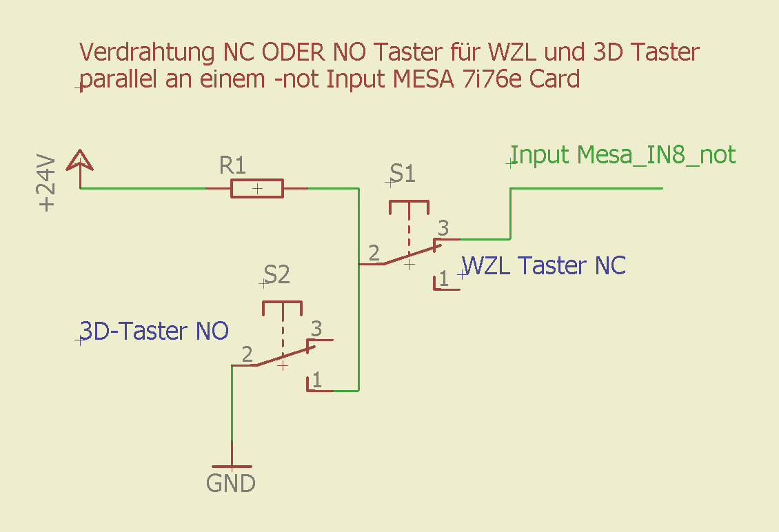

Hello again!
My next problem to get my machine running (it's running but not as precise as I want it) has to do with two switches.
My tool length sensor is a quite normal mechanical switch, that is NC and put +24V into input-08-not. That's working perfectly.
If I put my 3d Sensor (NPN-NO) into the line as the picture shows, nothing works. The 10k resistor (R1) before the Tool length switch puts the voltage down to 12.xVolts, the Input-08-not is set to "probing" permanently.
The 3D Sensor does nothing at all, not even the LEDs are active (the output is an open collector, I presume). What about diodes?
So, my next thought is to disconnect the two sensors from each other and use another Input of my MEsa 7i76e just for the 3D Sensor. This input should not be inverted for correct funktion. How can I do this with or without using an OR2 funktion?

16 May 2025 14:51 #328571
Replied by PCW on topic Two switches/sensors for tool length and 3d touching into motion-probe-in? Howto
You would need a stiffer pullup so you get more than 12V at the 7I76E input
I would suggest 2.2K 1/2W
You could also use two separate inputs and an OR or MUX component
(the MUX component has the advantage of ignoring the other input
when not in use, but requires a signal to select which input shouls be active)

17 May 2025 15:02 #328633
by Muftijaja
Replied by Muftijaja on topic Two switches/sensors for tool length and 3d touching into motion-probe-in? Howto
PCW, thanks a lot for the advice with the smaller resistor! I found one 2.2k with 1W in my boxes and used that today and voilá, it works as it should. Problem solved, I hope. (Don't know if I need noise reduction)Guys, I have no idea how to use sth like mux or mux_generic. I wouldn't even be able to use two inputs - but just out of curiosity , how would you do that in a HAL file if i would use an OR2:
