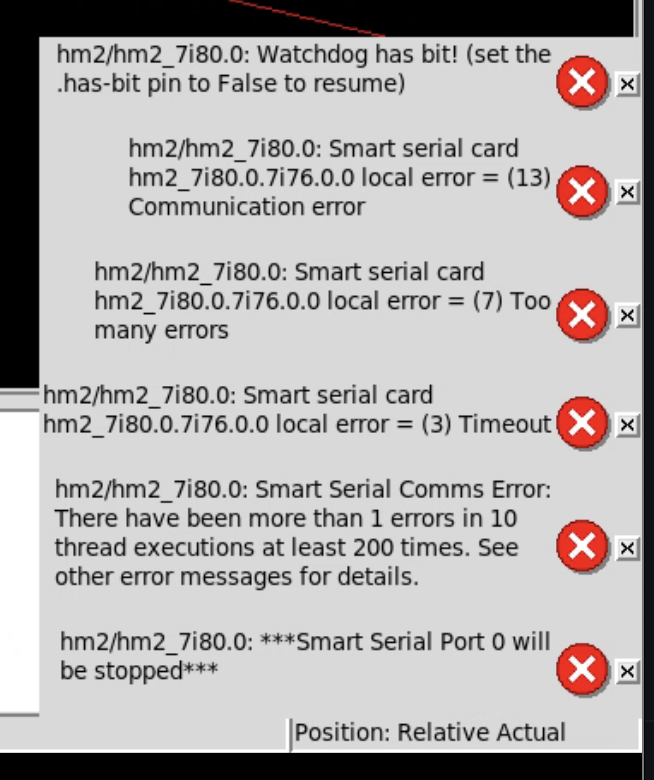

I've had to rebuild my machine after an SSD failure, and decided to move into the future.
I installed 2.9.4 and copied in my machine config files, everything worked out an issue initially but with in a few minutes I started getting the following errors

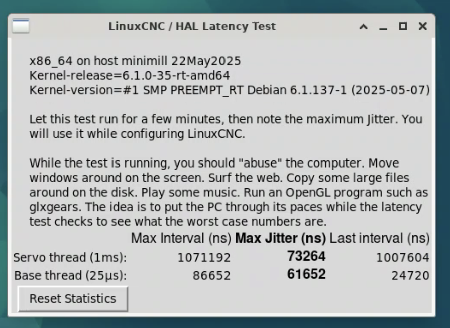

The latancy seems ok, running for a long time with glxgears and watching video via youtube and copying larger files

The root issue is not sserial related but latency related
(notice that the first error is a watchdog bite)
I would
1. Run a latency test
2. Check the network latency with:
sudo chrt 99 ping -i .001 -q -c 60000 10.10.10.10
or
sudo chrt 99 ping -i .001 -q -c 60000 192.168.1.121
(depending on 7I80 IP address setting)

Kept looking last night and ran the IRQ script found else where on this forum.
This seemed to improve things, I left LCNC running all night with glxgears and other things running and did not get the messages again.

If the PC has a RealTek network card, you will find a lot of replies here to install the DKMS drivers for it, i would skip that and try a new RT kernel, something like 6.11 or above.

I upgraded via backports to 6.12.22+bpo-rt-amd64, still get a 5ms max delay.
I ran it a few times
rtt min/avg/max/mdev = 0.053/0.116/5.600/0.269 ms
rtt min/avg/max/mdev = 0.054/0.099/4.908/0.216 ms
rtt min/avg/max/mdev = 0.054/0.106/4.672/0.241 ms
I've not had a warning since I ran the IRQ script.
We will see once I start actually cutting
