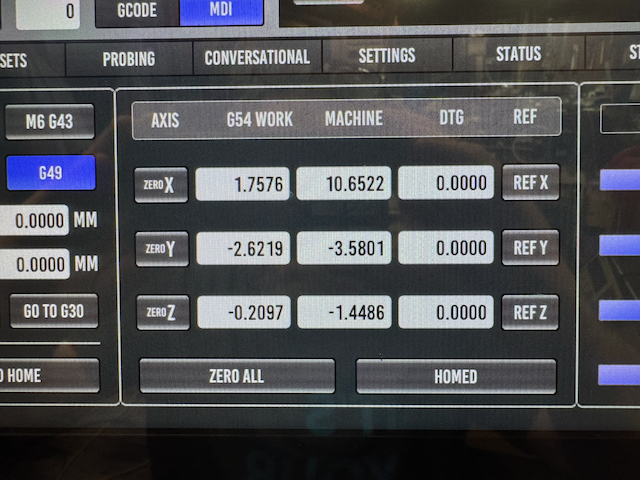

Not sure this is the correct topic, or where to start figuring out this problem.
I have a new build LCNC 2.9 from disto, EtherCAT, AC Servos with/ 23-bit absolute encoders, using ProbeBasic I have attached a screenshot with the issue show the Z-axis
"Sometimes" the "zero" will not display as zero, most of the time it works and will display as zero. On the screen, it will show a non-zero value (-0.297), and a G0Z0 does not move. If I move off that value and G0Z0 MDI, it moves back to the same non-value, also "zeroing" the Z-axis does not set the value to zero. I have seen this on all the axes, not just the Z, but the same issue. I have not seen a pattern yet, or what triggers it.
I am looking for an idea to explore the issue further.

05 Jun 2025 10:34 #329732
Replied by andypugh on topic G0 not zero?
Does the "G54 Work" change to G55 if you are in G55? (I am not familiar with probe basic)

06 Jun 2025 04:19 #329790
by kubes
Replied by kubes on topic G0 not zero? (more info)
After further testing and focusing on the Z axis, it is related to the limit switch. If I Z+ to the limit, then re-zero the non-zero value increase (G54). Each time I bump up to the limit switch, the value increases. Strangely, the actual (G53) remains the same (within a few tenths)
Also, if I "power off", meaning use the power button of the UI, and then power the system again, I can then correctly zero the Z. Meaning if I then press the zero Z axis, it will then set to 0.

06 Jun 2025 12:02 #329807
Replied by andypugh on topic G0 not zero? (more info)
I am now even more confused about what's going on.
Are you actually hitting the limit switch? Or do you mean that you jog to the top soft-limit, zero the coordinate system, and then jog away again this inexplicable offset appears?
Do you have anything like external offsets enabled? Any unusual kinematics?

06 Jun 2025 13:41 #329812
by kubes
BTW, thanks for helping!
I have limit switches on the Z-Axis, lower and upper. I
1. Jog positive and trigger the upper limit switch
2. Jog negative off the limit
3. "Zero" via the UI the Z-Axis
4. The W54 Z-position will "reset" to a non-zero number
5. The absolute machine position does not change
6. repeat 1-4
7. The "zeroed" W54 position will increase by around .300 with each jog cycle.
8. The absolute position remains the same for the Z-position I am zeroing.

[KINS]
JOINTS = 3
KINEMATICS = trivkins coordinates=XYZPlease Log in or Create an account to join the conversation.

08 Jun 2025 03:38 #329925
by kubes
Thanks langdos, I did a similar fix
I have absolute encoders, so I just set the soft limits.
Maybe there is an issue with hard limits? Should I report this? GitHub issues?

08 Jun 2025 15:06 - 08 Jun 2025 15:08 #329954
Replied by Aciera on topic G0 not zero? (more info)
A bit of a long shot, delete the .var and .var.bak files in your config and try again.
[edit]
Actually I'm not sure if ProbeBasic uses .var files at all.
