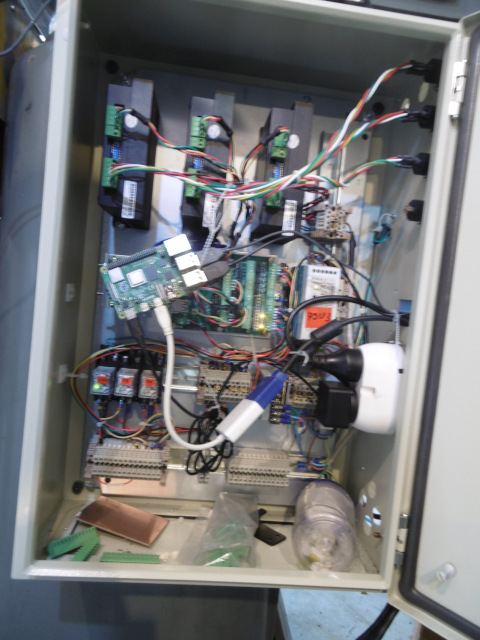

Raspberry Pi 4B 4GB has operated a very conventional x,y,z mill with a Mesa 7i96 for a couple of years.
WiFi never worked and has been a back-burner issue for a year or more.
Two cubicles:
- Power: VFD, stepper supply, general supplies, AC/DC relays,
- Electronics: RPi, stepper drivers, DC relays, power supplies,
- minimal 240VAC cabling for power supplies, monitor.
Monitor, keyboard and mouse cabled.
WiFi-Extender for workshop 4m from RPi.
Test set-up on workshop bench 6m from Extender.
Bench desktop ethernet cabled to extender, has always had reliable WiFi.
I have two RPi; 4GB and 8GB.
The 4GB is currently LC2.9.2, and I downloaded LC2.9.4 recently to a separate SD card.
Investigated:
- both 4GB and 8GB operate WiFi with either L2.9.2 or LC2.9.4 on the bench no problem,
- confirmed linked to the Extender by switching it Off (house WiFi 5G is at -70dBm),
- both operated with Mesa card Off,
- both fail to launch WiFi in electronic cubicle when mounted or hung in free space.
Also:
- both have identical (as close as I can tell) WiFi set-up,
- both detect the Extender and show signal level at -40dBm,
- both fail to scan for ssid using menu-config in LC2.9.4,
- both respond to "iw dev wlan0 scan" with response for Extender at -40dBm.
Note: test in cubicle has all non-essential supplies Off: VFD, steppers, Mesa, general control,
nothing else in workshop energised, other than air conditioner and desktop.
Need suggestions on which stone to turn over next.
John.

12 Jun 2025 08:41 - 12 Jun 2025 08:44 #330197
by electrosteam
Replied by electrosteam on topic WiFi Problem on Raspberry Pi
Steel, 400 x 600 x 190.
See attached (poor) photo showing RPi hanging in space:
Row 1: stepper drivers,
Row 2: RPi stacked on Mesa, I/O PSU,
Row 3: 12 Vdc relays, Mesa core PSU,
Row 4: Terminals,
Side: stepper sockets, hole for monitor+keyboard+mouse cables, GPO for monitor + RPi.
Terminals and cables as appropriate, much neater generally.
I have a virtually identical cubicle with some electrical equipment in it.
Stripping and testing should begin next week.
The RPi 4GB and L2.9.2 need to go back to their day job of cutting metal.
John.
Row 4: Terminals,
John.

12 Jun 2025 10:22 - 12 Jun 2025 10:24 #330200
by unknown
Replied by unknown on topic WiFi Problem on Raspberry Pi
A grounded steel enclosure is not the best place to be emitting radio signals from.
Nowadays just about any wifi dongle will work, but it will need an external antennae.
Should a good starting point for usable wifi adapters, anything that works with Debian Bookworm will work.
github.com/morrownr/USB-WiFi
If you need extra help I'm located in Sydney as well.

24 Jun 2025 10:31 #330800
by electrosteam
Borrowed a dongle, TP-Link TP-WN722N, from a Forum Member.
Got an external antenna from another Form Member.
Much swapping and shifting around between bench, cubicle and cabled as far from cubicle as lengths would allow.
Dongle, antenna, 4GB and 8GB, power supplies, LC2.9.2 and LC2.9.4, etc etc
The Dongle works fine, Ebay says $15.
Eventually replaced the monitor on the mill with the one from the bench.
SUCCESS.
Even works in the cubicle with door open without the dongle.
Who would have thought !
Suggestions welcomed on what to do with the faulty monitor.
I am in Kingswood if you want to drop by and take it off my hands.
