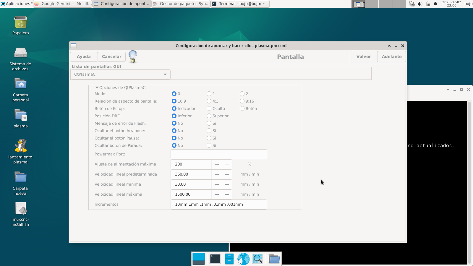

02 Jul 2025 04:28 - 02 Jul 2025 11:25 #331086
by Johnnysacalu
Replied by Johnnysacalu on topic Configuración thcad2 con mesa 7i96s
Uso qtplasmac pero no me sale esa opción para thc . No se por que instale linuxcnc 2.9 master puede ser por eso?
O tengo que cambiar el firmware lo tengo en 7i96s_d quizás poner 7i96s_dlp resolveria que me salga esa opción de verdad no consigo configurarlo

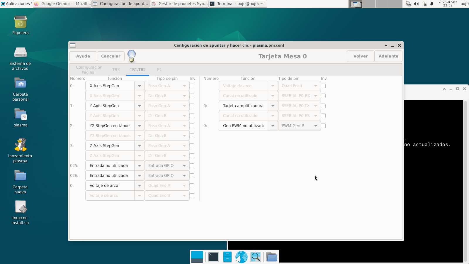

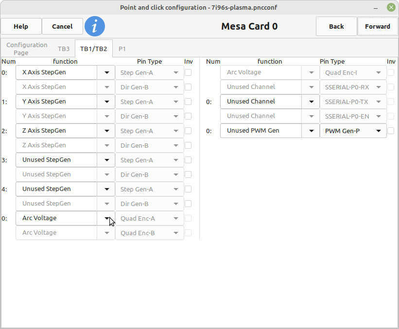

I'm using 2.9.4
Did you select "Arc Voltage" on the encoder menu on the TB1/TB2 tab?
- Johnnysacalu
- Posts: 39
02 Jul 2025 15:25 #331109
by Johnnysacalu
Si

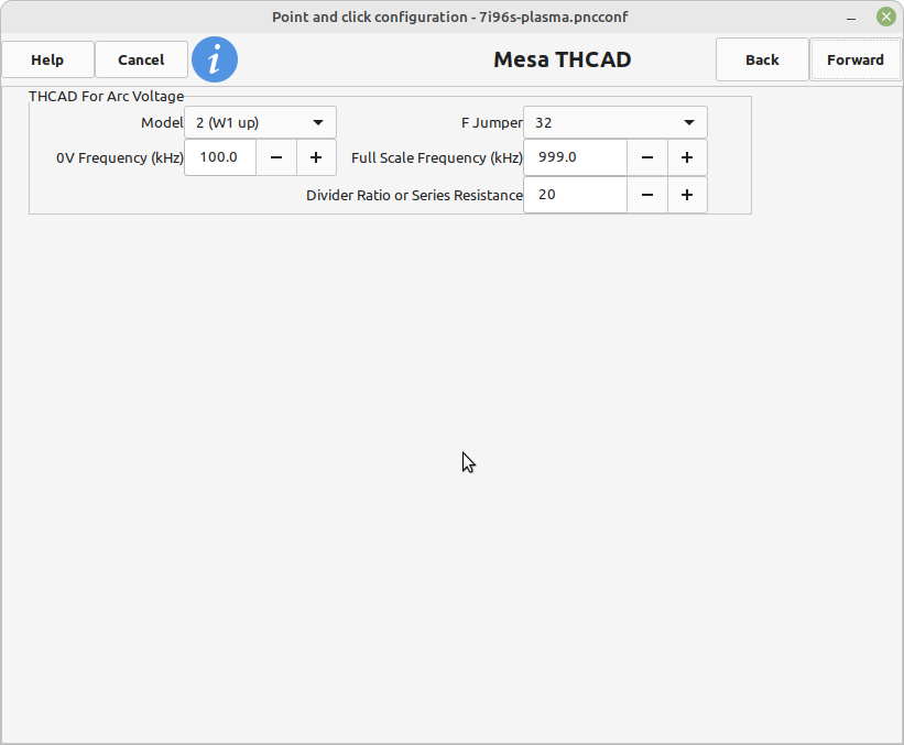

The THCAD support was added to pncconf about 3 years ago so definitely in 2.9.4
The THCAD screen should appear on the next screen after the one where
you set the stepgen/encoder functions.

02 Jul 2025 23:34 #331134
by kworm
Replied by kworm on topic Configuración thcad2 con mesa 7i96s
Hi, I had the same issue and there was a problem with pncconf displaying the THCAD page if the pin number was 0. I made a pull request that has been merged a couple of days ago into 2.10 master. You could either use an input that doesn't have a pin number of 0 or upgrade to the 2.10 master.
Hope this helps.

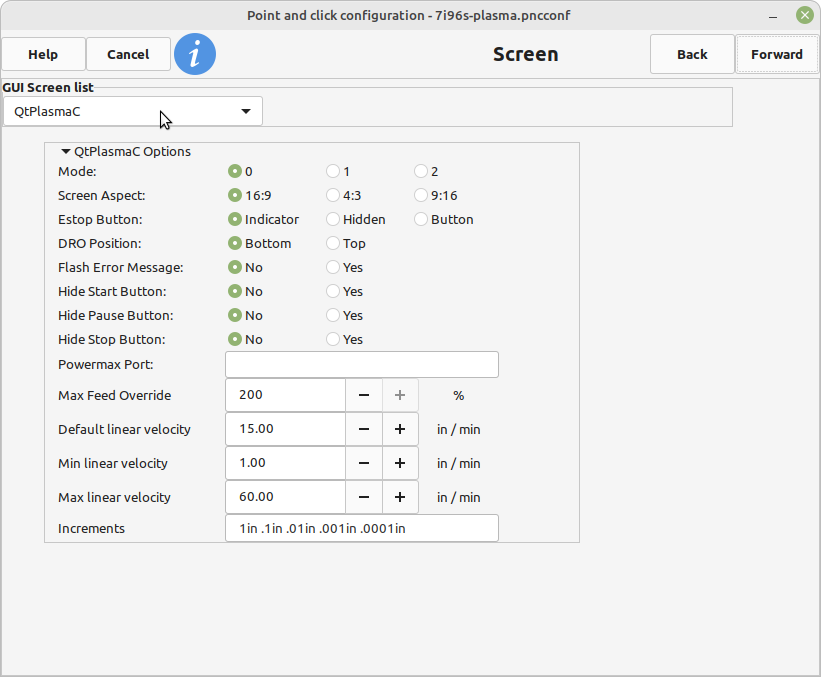

Replied by PCW on topic Configuración thcad2 con mesa 7i96s
I don't think there is a pin 0 issue as this is a 7I96s and the encoder is on pins
27,28,29
Language may be the issue, I don't know enough about locales and translations
but do all strings in the source get translated? (en_US):
if "Arc Voltage" in pinchanged:
self.d._arcvpin = pin
elif self.d._arcvpin == pin:
self.d._arcvpin = None
if self.d._arcvpin and self.d.frontend == _PD._QTPLASMAC:
self.p.page_set_state('thcad', True)
else:
27,28,29
else:
