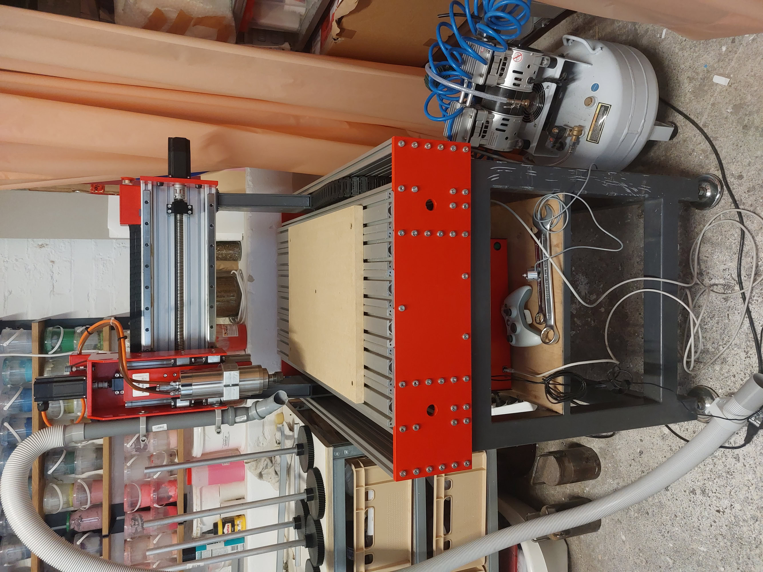

sorry this this probably a very basic problem but I couldn't find a solution myself: I can jog the machine out of the axis until the limit switch triggers. I have shared home/ limit switches and my understanding was that after homing the machine would know where it is and prevent jogging until the limit is triggered.
I suspect my Home / Home offset / min limit is the likely cause but as I said I cant figure it out
Currently I tried
HOME = 5.0
HOME_OFFSET = 0.000000
MIN_LIMIT = -1.0
I also tried
HOME = 0
HOME_OFFSET = -0.800000
MIN_LIMIT = -1.0
but both still do not prevent me from jogging the axis until i get an limit error at which point I have to restart the machine and manually move the axis free.
Thanks!!

I made the config with PnCconf and only slightly changed to to account for probe basic interface.
the inductive endstops are mounted on the traveling part of the axis and there are metal stops at each end of the travel.
the machine has the following specs:
Machine Specs:
X460, Y750mm, Z160
20mm linear rails
10mm pitch ballscrews, 20mm diameter
Construction: aluminum profiles bolted to 12mm steel plates, welded gantry sides
Motors: Y-axis 6.8Nm stepper, Z + X-axis 3Nm stepper
Drives: DM556 V1 48v
Spindle: 24K RPM 2.2kW ER20
inductive endstops
good latency values mostly sub 3000ns servo

If you have a shared home/limit switch you need to add a HOME_OFFSET to move off the switch during homing. During normal operation including jogging, the limit switch should never be triggered unless Oh Sh#t happens.

thanks, yeah I think that is the problem. Sorry again to ask: Should this value be positive or negative in my case, where the machines homes on the min X/ Y side (and switch is on the moving gantry) --
I assumed negative as the HOME_OFFSET specifies the position of the limit switch in relation to the actual home position. Is that correct?

Slow your velocities down and see.
I think the sign is the opposite of LATCH_VELOCITY
One of my machines:
MIN_LIMIT = -106
MAX_LIMIT = 0.01
HOME = 0
HOME_OFFSET = 1
HOME_SEQUENCE = 0
HOME_SEARCH_VEL = 5
HOME_LATCH_VEL = -2
HOME_IGNORE_LIMITS = yes
HOME_USE_INDEX = NO

I got it: the problem was that the [AXIS_X] section had the same settings as the [JOINT_0] section, basically setting the allowed range for the axis to the same range as the physical reachable positions. My corrected .ini values are now:
[AXIS_X]
MIN_LIMIT = 0
MAX_LIMIT = 455.0
[JOINT_0]
HOME = 0
MIN_LIMIT = -1
MAX_LIMIT = 455.3
HOME_OFFSET = -0.5
