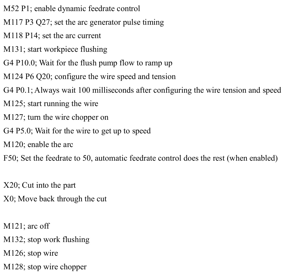

I recently completed a wire EDM machine (not my design) and LinuxCNC runs it, and though I have a sw background, I have zero experience with it.
The very first job it's running, "First Cut" is very simple, checking that the hardware works, powering everything up, making a simple straight cut, then backing out and powering everything down. Because of all the new hardware, I want to single-step through this short job. See below.
The issues:
There are two buttons, "Run" and "Step." I first tried repeatedly pressing Stop and it seemed to work at first, but after about the fourth press, the program took off as though I'd pressed Run. An online reference (AI generated) said to press Step once, then repeatedly press Run, which will advance one line of G-code at a time. Thing is, when I press Step, Run grays out and cannot be pressed, so I don't understand (hence why I pressed Step repeatedly.)
On a related note, when pressing Step, I expected LinuxCNC to indicate the line of G-code that's being executed, but it does not. It's possible that's because I'm not using Step correctly, that it's never being activated, but I don't know.
Lastly, after pressing Step once or twice (don't remember), I get the following error message: "Cannot use axis values without a G code that uses them." I don't know what this means. [Edit: looking online, it appears that this is due to the line "X20" appearing along by itself, with no G-code ahead of it. A puzzle is how the program advanced all the way to the X20 line when I only pressed Step a couple times...]

Solved!
To use Single-Step, you must:
1. Press Run ("R")
2. Press Pause ("P")
3. Press Execute Next Line as required (why it's not called Step I don't know) ("T")
Quirks:
While it does single-step, it only does so for motion-related instructions; everything else gets executed and full speed. If there's a way to truly perform single-stepping, I'd like to know.
Due to the above, single-step only highlights motion-related lines, so everything else doesn't get highlighted.
This thread can be closed!
1. Press Run ("R")
Quirks:
