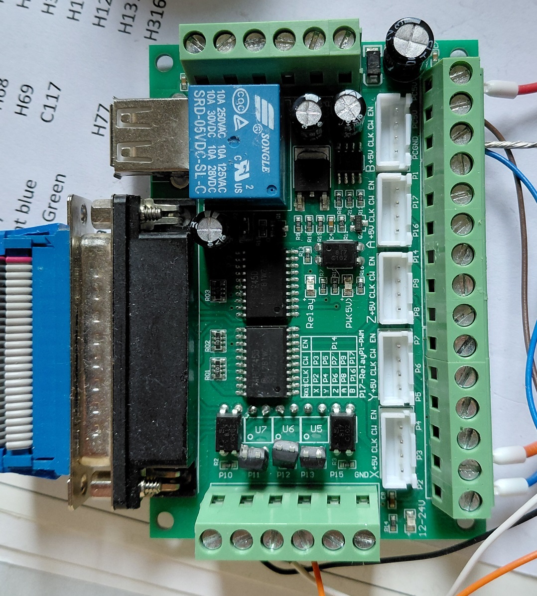

I'm loving hearing this, as I've never used RPI I was interested for two reasons, one because it's very compact and the other because it uses its compact and cheap touch screens, but I'm afraid I'll have difficulty as I've never touched one and I need a lot of help from you... In parallel to this subject in relation to 7i92H, how do you do in relation to the spindle since it doesn't have a 0-10v analog output?

Mesa have a product called spinx or similar, converts digital pwm to isolated analogue out.

This Chinese BOB has 0-10v analog output. The price varies greatly $5 - $15.
