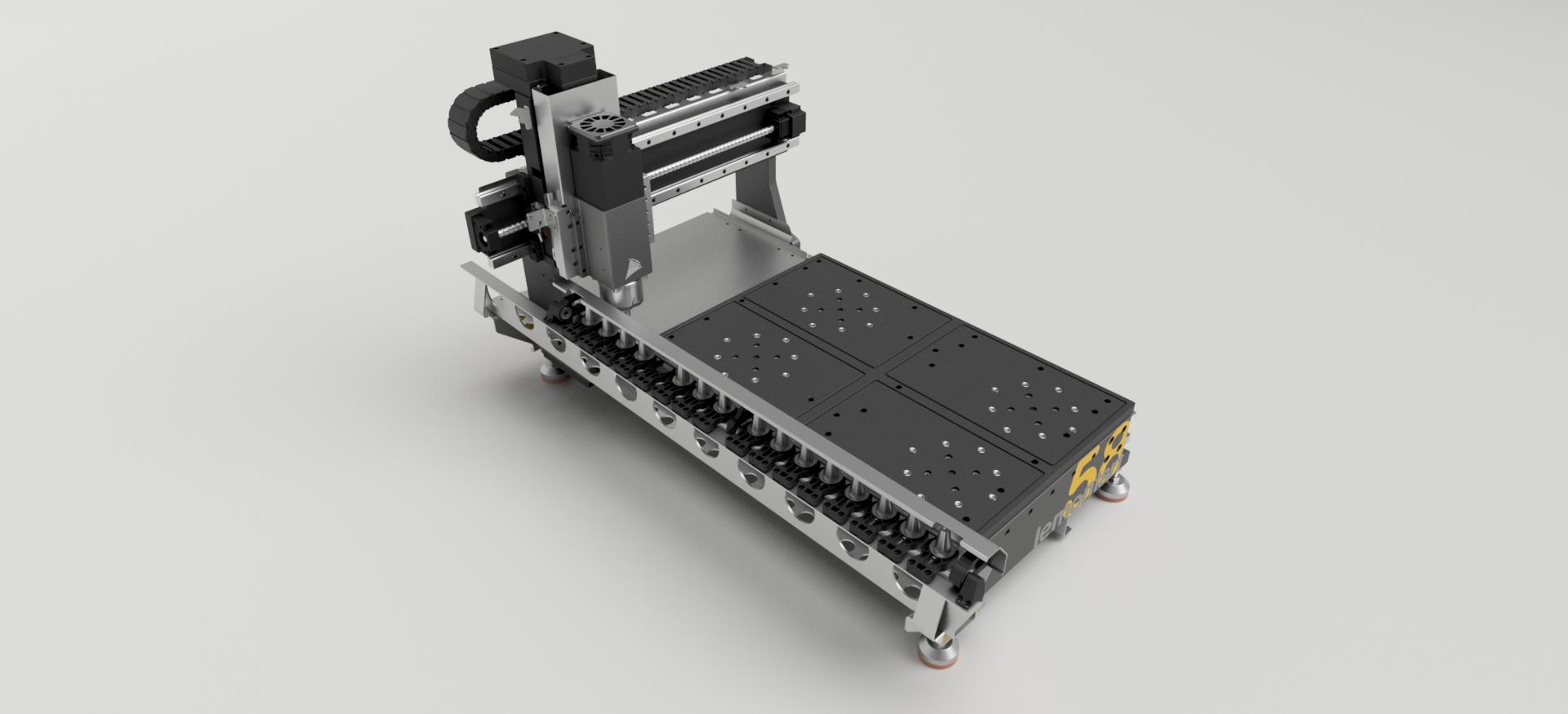

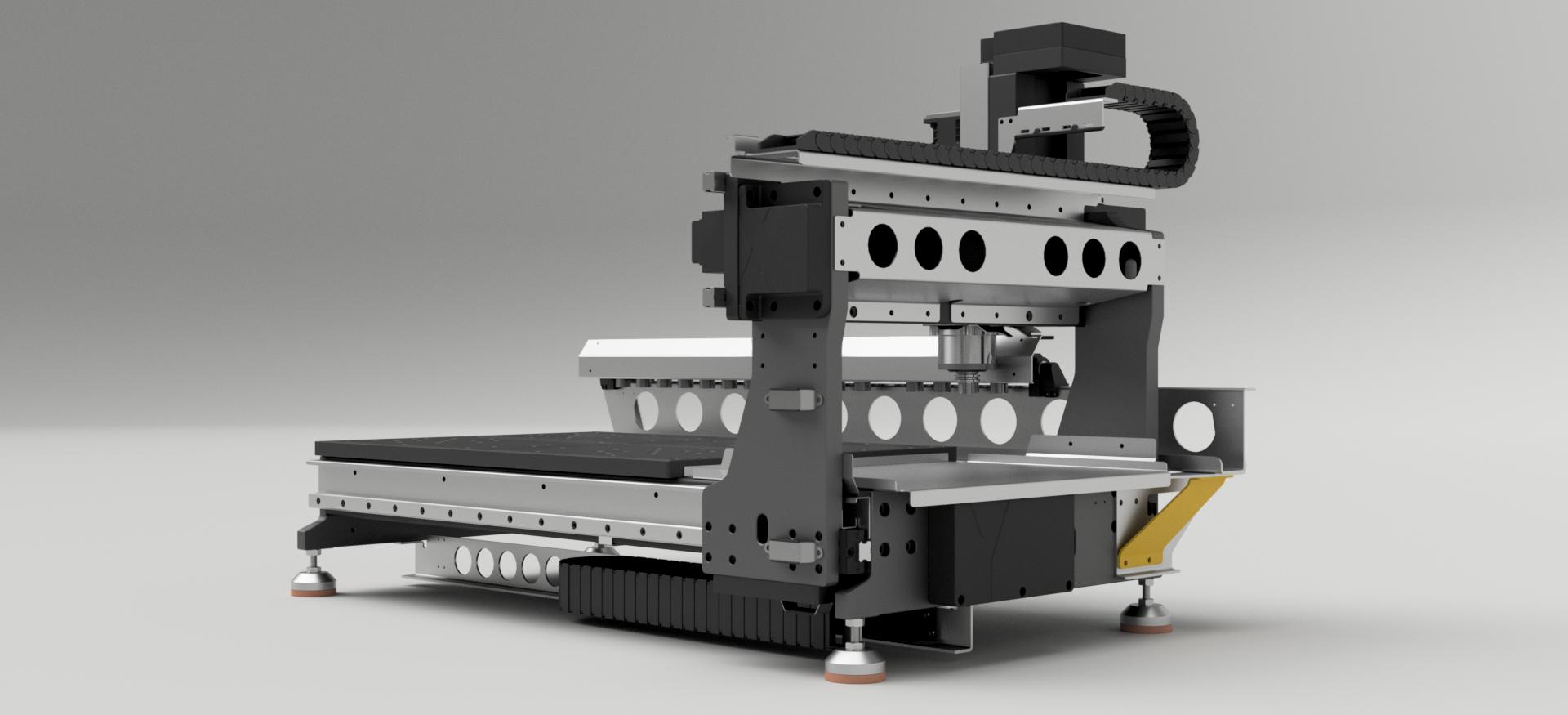

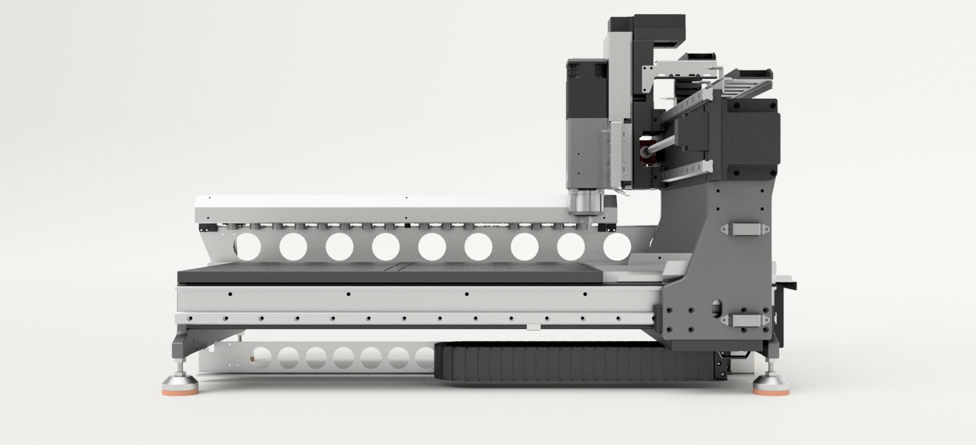

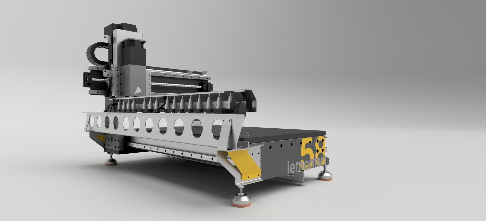

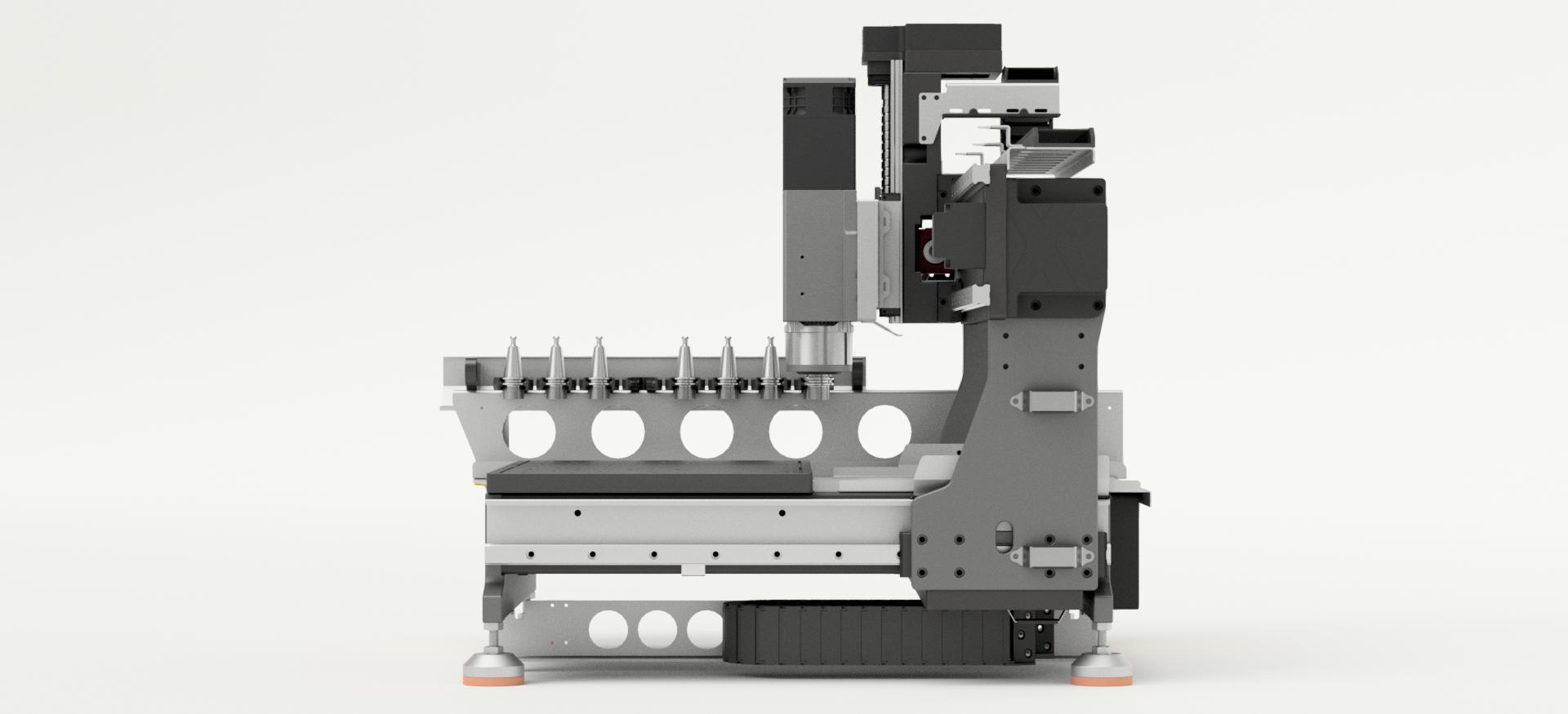

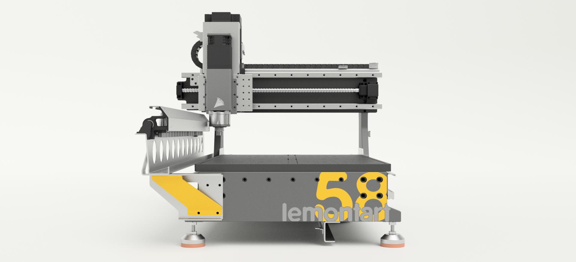

So, just to side track a little....
Where would you stick the control? Assume the machine is open, cause its a wood machine.
Would you put an arm on the machine frame, our would you put it on the stand? I feel like cause the stand is optional/variable, mounting it to the machine is better. off to the right side (viewed from the front) vertical 15" capacitive touch. with a little printed housing for a clusters of physical buttons and e stop.
Thoughts?
Thoughts?
