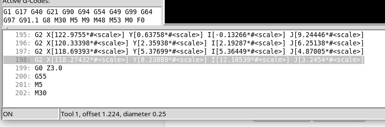

Consider the following gcode lines:
197: G2 X[118.69393*#<scale>] Y[5.37699*#<scale>] I[5.36449*#<scale>] J[4.87005*#<scale>]
198: G2 X[118.27432*#<scale>] Y[8.23889*#<scale>] I[12.16539*#<scale>] J[3.2454*#<scale>]
199: G0 Z3.0
200: G55
201: M5
202: M30
LCNC reads/runs all the way down and stops at G0 Z3.0. And the program never resets. I stat.red_line, stat.motion_line, current_line, and see that motion_line is actually the line it is stuck on. In this case, it would be line 199. After 202: there is an EOF carraige return. I tried this using Axis, and all the others. I get the same result these do.
M30 should read and rewind to first line in the program which is RS-274 GCODE. But, no matter what I try, nope.
Any ideas?
Thanks,
Don

- Donb9261

7 months 3 days ago - 7 months 3 days ago #345018
by Donb9261
Replied by Donb9261 on topic LinuxCNC python
Last edit: 7 months 3 days ago by Donb9261.

- Donb9261
- Posts: 169
- Thank you received: 103
7 months 6 hours ago #345158
by Donb9261
Tommy,
The replies demo what is actually happening in hopes I may get some guidance to fix it. My question is above them.

I made this work around that seems to be robust.
if cur_task_mode_mon == 1 and cur_interp_state_mon == 1 and cur_queue_mon == 0:
cmd.abort()
M30 is actually read into the buffer and executed, but the inerp has already reset before updating the line number que. That is a bug in Linuxcnc and breaks the standard function of M30 in RS274.
I may simply modify my lcnc to fix the issue. But for now, the above works and should only activate if the yask_mode is manual, which M30 does actually set on M30 read, the task_state is idle, which it should be, and the queue is empty. Which is the planner que.
cmd.abort()
