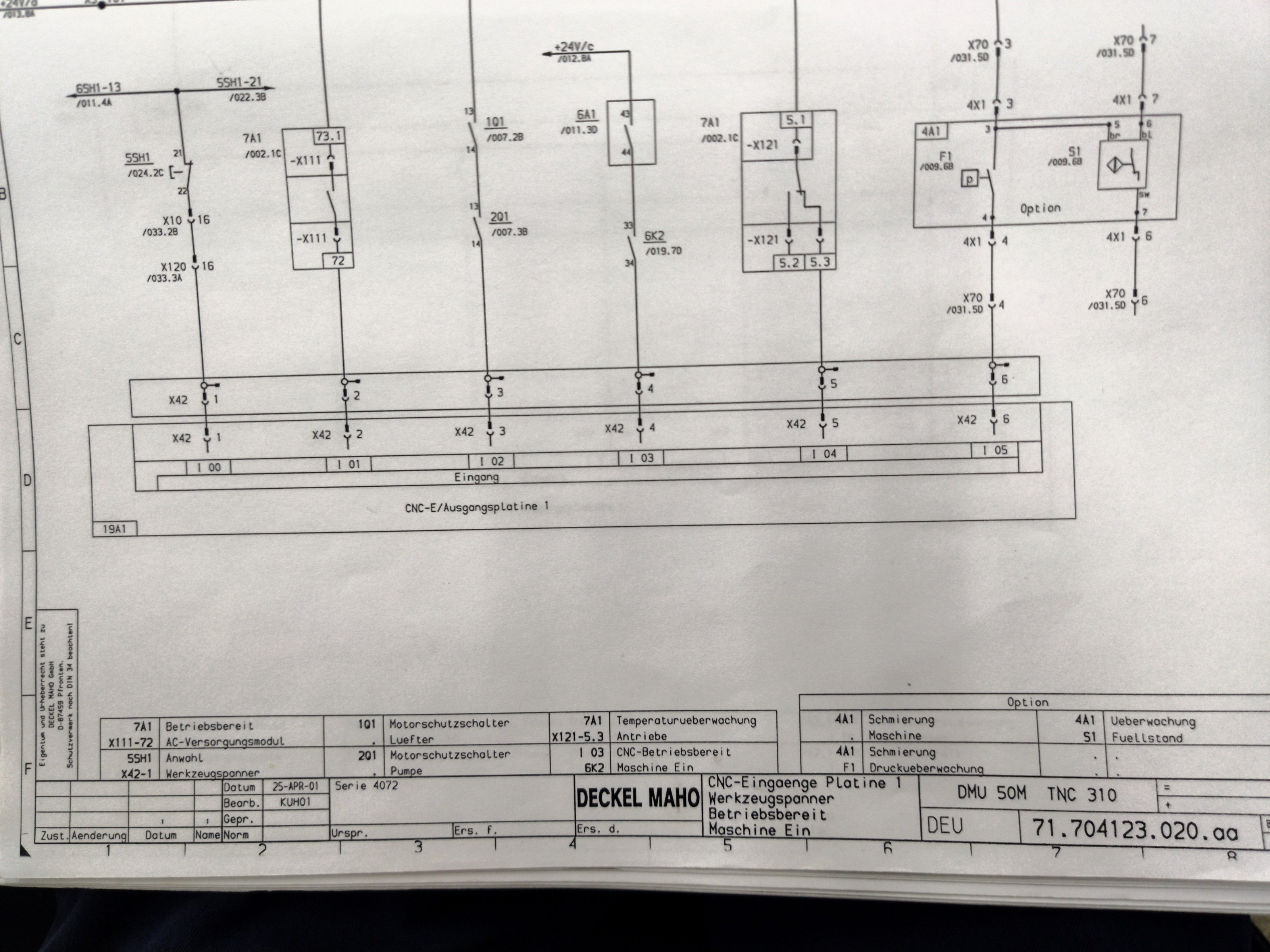

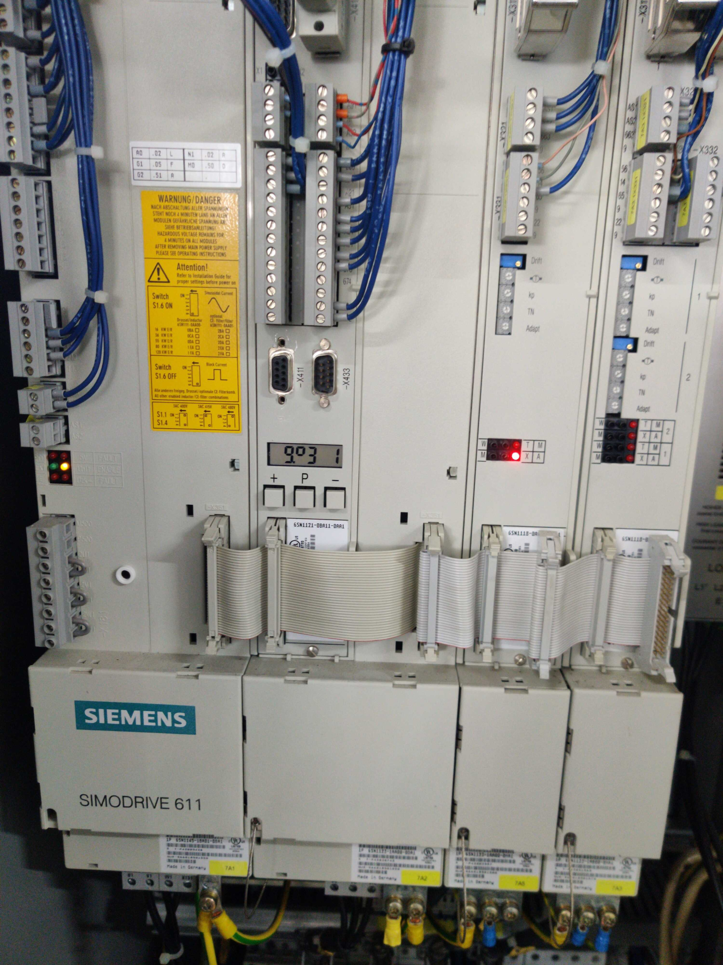

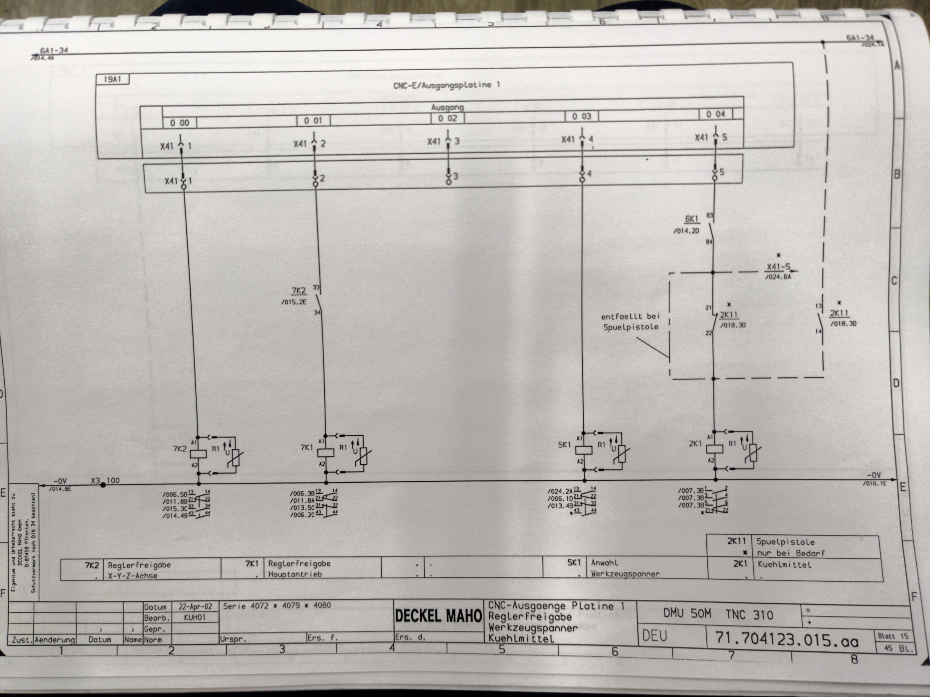

I'll attach the HAL, INI and some pictures of the servo drives and the relevant pages of the electrical documentation.

How exactly is your servo AC power on handled? My Simodrive is sort of old, as you may see — the servos are 6SN1118-0AD11-0AA1 and the control board is 6SN1121-0BA11-0AA1.
mine are from 1992 (mill) and 1997 (lathe) and judging by the pictures your simodrive looks like new compared to mine, but I had both power supplies repaired and also main spindle drive for lathe and Z axis drive for the mill
red led H1 axis fault is on page 83 and 84 from documentation
adegis.com/media/asset/eb8a4b2af69aebb3f...84e8f10fe17ff0ed.pdf
you can try swapping z and x drive motor connection (and encoder wiring and everything else) to see if it's not your drive that is failing

24 Feb 2026 17:23 #343417 by radom
Oh, also, my braking/release signal is a single one for all 3 XYZ drives. Is it possible to try and separate them electrically? Most likely. I'm not sure that's a good idea, though.
Now I'm wondering if you are looking at the correct thing
is there anything in the electrical diagram as "Z achse bremse"?
