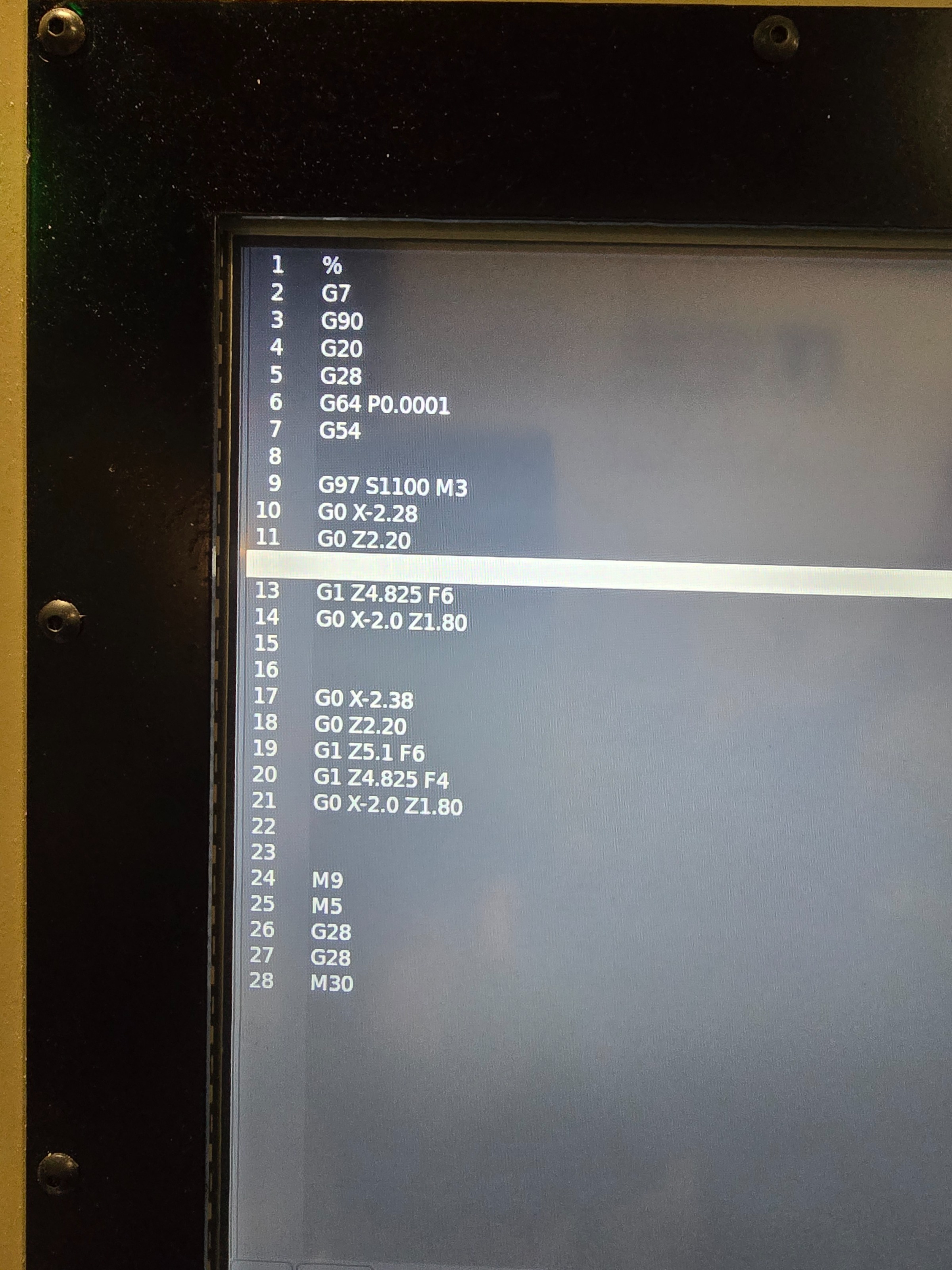

I'm having an issue that I couldn't find a solution that worked. I prefer Adwaita Dark theme. Everything is fine that is when I go to edit a gcode file in linuxcnc, the text highlight washes out the text. See image:
During my search I have found a script to add to the user command file, it just seems to crash when it tries to load. I have attempted to change the editor in the INI from gedit to mousepad, heck, I can actually leave it blank and it still changes nothing. I have changed the theme to use the system settings, still no change. The only way I can get this to where I can read the highlighted text is to change out of dark theme which isn't ideal. I'm sure there's a solution, I just haven't found one that works. Anyone else find a fix for this?

This is on Mint 22.3 with Mint-L-dark theme, notice the text on the left is clearly visible, on any other black theme no text can be seen there.
And this is not limited to LinuxCNC, many other programs i use daily had the same issue before so i had to revert to bright themes when using them.
What GUI are you using?
I know Axis can be modified, and so can the QT versions.
You can also try to install Mint themes in Debian, or Ubuntu themes. See also Ubuntu Studio as they do have some very nice themes, but forgot what they use as DE.
