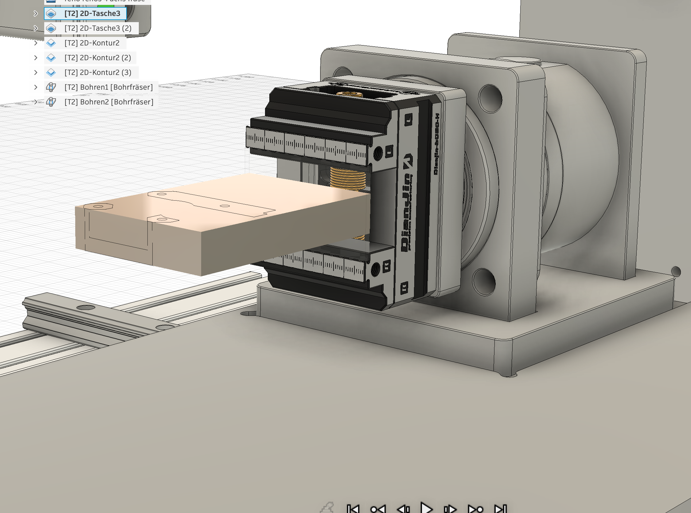

Looking for some community advice:
I’m planning to add a 4th axis (rotary A-axis) to my milling machine. In principle, that’s not a problem. What I’m wondering is how to best handle situations where the stock isn’t clamped perfectly centered in the chuck/vise.I think it’s unrealistic to expect the workpiece to be mounted absolutely concentric every single time.I’m using the Probe Basic interface. I checked the probing functions to see if I could probe and compensate with G52, but that doesn’t seem to be possible.
How would you approach this? Would you probe the offset somehow, use a different work coordinate system, or handle it another way?I’d appreciate any tips or suggestions!

I program (F360) using the center of rotation as Y0Z0.
Your example shows a self-centering vise, and I assume it'll be connected to the axis with a zero-point system. If your adapter plate is adjustable you can indicate the adapter & zero-point chuck in very close. From that point on the vise should self-center close enough.
For round parts (3-jaw chuck) treat it like a 'set-true' lathe chuck. Chuck up the part and indicate it concentric with the axis of rotation (dial test indicator). Loosen the chuck on the backplate and tap it around.
Once it's turning concentric the Probe Basic 'Ridge & Valley' probing routine (in Y) will find Y-axis center. Once you have Y-center, probe in Z and then adjust Z-offset based on stock diameter.
As far as probing the center of rotation for a prismatic part - assuming you've adjusted your vise & zero-point to be on center...
The above headache of indicating is why I switched to encoder index homing on my A-axis, and am in the process of doing the same thing on my XYZ axes.

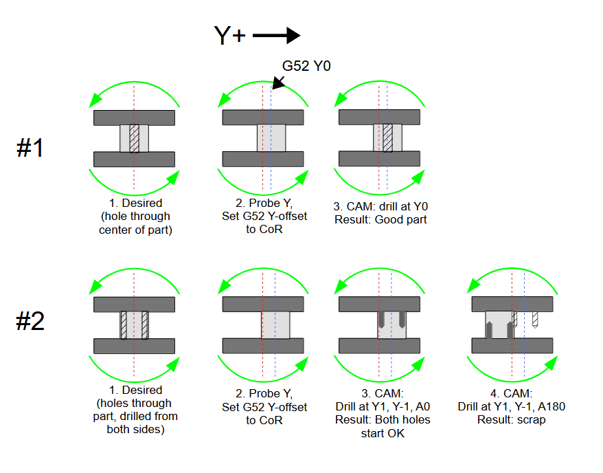

The idea:
1. Clamp the stock (no need to center it carefully)
2. Run the macro — it probes at A=0° and A=180° in Y, calculates the midpoint, and sets G52 Y to the center of rotation
3. Swap to the cutting tool and run the program
With the WCS origin set to the rotary axis in CAM (Y0 = center of rotation), one single setup covers all rotation angles. No skim cuts, no calipers, no manual offset math — roughly 30 seconds per part.
G52 persists across resets in LinuxCNC by default, so the machine-level calibration (the fixed offset between G54 and the rotary axis) only needs to be done once after homing. The macro then corrects only for the actual clamping offset of each individual part.
What do you think?

I've attached an A-axis probing routine - it's from PathPilot. I think it's suitable for cylindrical stock along A, not really for prismatic stock.
I've not tested it, but it'd probably be a good starting point for someone to test/tweak and then submit to the ProbeBasic devs for inclusion in PB mainline.
For this to work the following must be true:
If you have TCP that takes care of everything.
If you adjust CAM after probing, that also takes care of everything.
But just probing and shifting Y will result in bad parts unless you're only machining at one A-position.
I didn't draw the other problem... but not only will features not line up, the part will orbit the actual CoR, which means at A90/A-90 the Z-position will be higher/lower than CAM expects it to be. Maybe crashy-crashy.
The only reason to probe is if you're doing 2nd op parts and have to line up features with existing surfaces. Even then you'll probe, adjust CAM (or TCP), and pray.
Or use a work stop that gets the stock centered enough to take care of a little excess material - roughly 1 second per part.

Thanks so much for the detailed response and the PathPilot macro — really appreciated!
You're absolutely right that blindly setting G52 Y without accounting for Z would cause the orbit problem you described. That's an important warning and worth highlighting.
The key assumption I should have stated more clearly upfront: the CAM origin must be placed on the rotary axis itself — not on the stock surface. With Z0 and Y0 both sitting on the center of rotation in CAM, the G52 Y correction only compensates for the actual clamping offset of the stock, and the orbit problem doesn't arise. The part isn't referencing a point on the stock that moves with it — it's referencing the fixed axis center.
With that setup in place, I think TCP isn't needed either — Fusion pre-computes all positions for a table-type A-axis, so the controller just executes straight X/Y/Z/A moves.
Thanks again for pushing back on this — it forced a much clearer explanation of the preconditions.
I still fail to understand the point of probing and using an offset. What exactly are you offsetting?
If you position the part mostly in-line with the actual CoR and program a bit of extra stock in CAM, you will never need to probe and you will never plow in to unexpected material.
- If the actual CoR position is not known and you probe the part - you don't know how far to offset.
- If the actual CoR position is known and you probe the part, you know how much to offset, but
- the CAM doesn't know how far you've offset, so features will be machined in relation to the CoR, but not to the stock position
- In the case of a profile-type toolpath - depending on how far offset the stock is from actual CoR - you will need extra material on one side and risk taking an extra-heavy cut on the other
