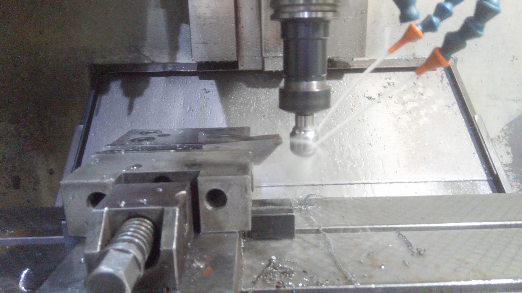

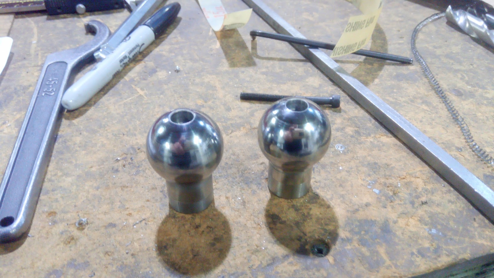

16 Jul 2026 14:09 - 16 Jul 2026 14:10 #347810
by MikkelRS
Replied by MikkelRS on topic running the spindle as a lathe spindle
Having done this on many occasions but on other CNC machines, its just using what you got to make what you need.
Ive turned near full spheres on the end of a stick using a 3/8" round button insert lathe tool clamped on whatever angle in a vice, probably easier with button inserts- easy to touch off on.
The more difficult part is coming up with the NC code to do it- its not really a linuxcnc thing as a CAM thing. I was using mastercam x9 at the time, created a program using an inverse offset chain to drive the spindle/x/z in the right motion to achieve the part. Depending on the accuracy you require- you may need to include cutter geometry/radiuses to do it. In my case above the button insert radius was added to my offset via telling mcam the tool was 3/8" ball nose.
Was also able to hold a tolerance of around ±0.0002" with some fiddling around in A2 tool steel.
