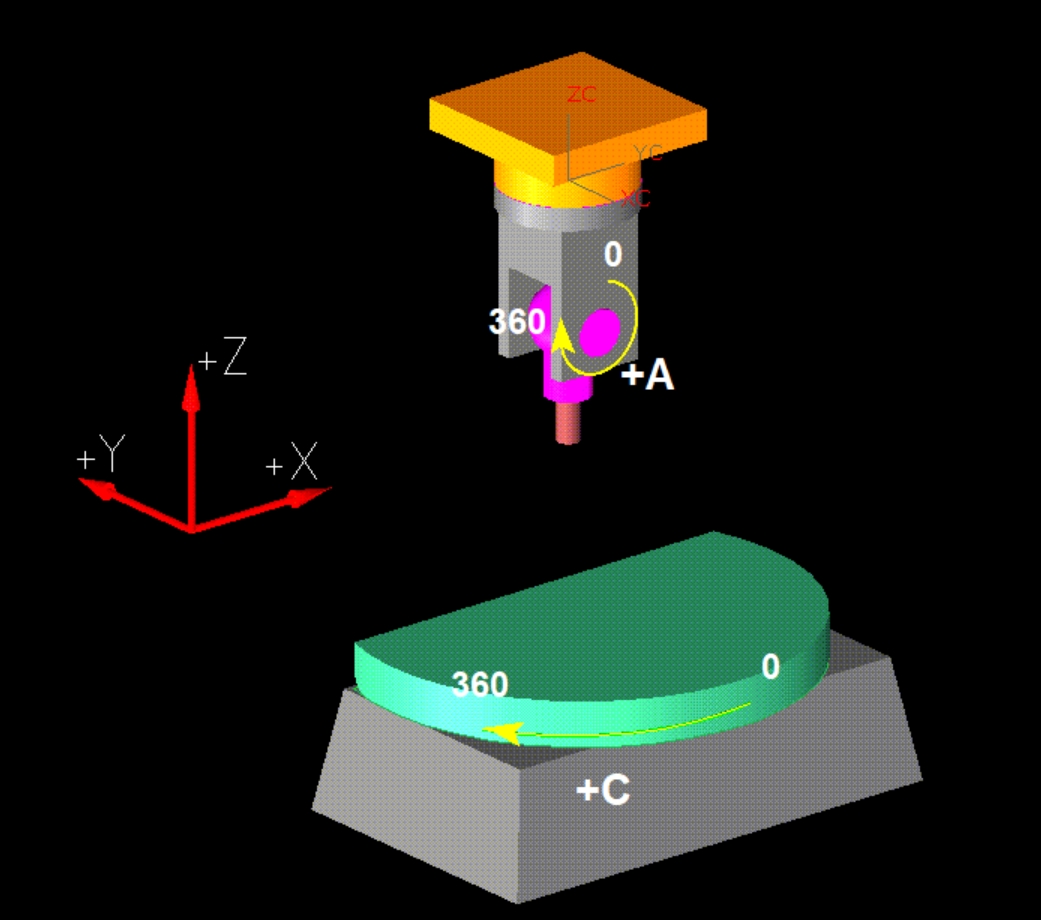

Hello everyone, I'm a DIY enthusiast. My English isn't great, but I'll try my best to explain clearly. I'm encountering a problem while using LinuxCNC as the operating system for my machine tool. When I replace the existing kinematics system with my own custom-built five-axis kinematics system, the machine tool coordinate values change when I switch to RTCP mode at the current position, causing a system alarm because the machine tool coordinate system has exceeded its limits. My understanding is that enabling RTCP changes the workpiece coordinate system values, not the machine tool coordinate system values. I haven't been able to solve this problem yet.
Additionally, my machine tool structure is A (head), C (table), with the distance from the C rotation center to the machine tool zero point being (Xrc, Yrc, Zrc). The tool length is set to dt, and there is an offset between the two rotary axes with offset values of (Xos, Yos, Zos).

Replied by Aciera on topic The machine tool coordinate system shifts before and after RTCP is turned on
Make sure you test your kinematics for A=0 , C=0 first so you can confirm that the kinematic model returns proper results. Also make sure that the coordinate values switch between the same values when you change between trivial and RTCP kinematics.

Not sure what you mean by 'the basis' but in a machine kinematic model we usually want to find a transformation between the work coordinate system and the tool coordinate system so in that sense I would say it is necessary to use the tool coordinate system.
2. Note that the kinematic in the paper you refer to has both rotations on the work side (ie table rotations) while your setup has one rotation on the work side and one on the tool side. This means that both (tool and work) coordinate orientations can change with respect to the world coordinates ('world' can be seen here as the machine frame). I'll attach a different pdf that handles a very similar setup as yours. It is a bit more complex as it describes a nutating spindle joint but in your case the nutation angle would simply be 90°. There is also a second kinematic model that can be used for 'Tilted Work Plane' machining.
[edit]
There are a LOT of ways to get a kinematic model wrong so I would recommend using computer assistance to do the matrix calculations. You can find the corresponding jupyter notebook here:
github.com/Sigma1912/LinuxCNC_Demo_Confi...tary/xyzbc-sntr-docs

Hello, Aciera
After reading the paper you sent, I gained a lot of insights. Based on the method described in the paper, I successfully derived the kinematics that fits my machine tool configuration. Currently, it has been successfully implemented on my machine, and no other issues have been identified so far.
Lastly,thank you very much for your help!
