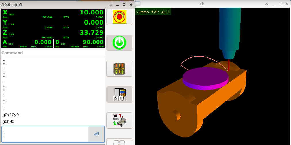

I'm setting up an real milling machine with xyzab_tdr_kins kinematics.
To avoid unnecessary questions, I emphatically declare that everything is correct in my configuration, I made all changes on purpose, it was supposed to be like that, it works well and has no connection with the described below error.
Since this is a real machine, it has real parameters in the ini file.Unfortunately, the Z-axis travel is only 110 mm, but as it turned out, this was a bigger problem than I expected....
After basing it looks like this:
Then I issued some commands, which you can see in the MDI window.
So far everything works as it should, but after executing G12.1 miracles happen:
If you look closely at the pictures above, you can find the reason.

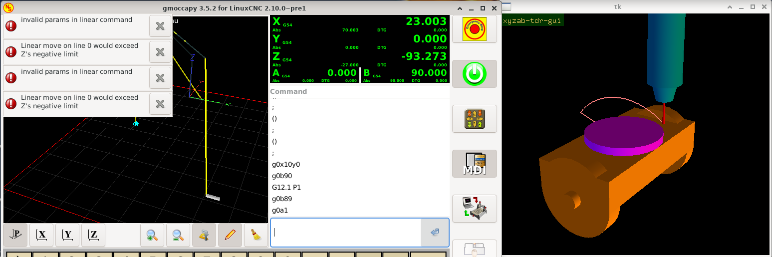

The explanation of this phenomenon is extremely simple.

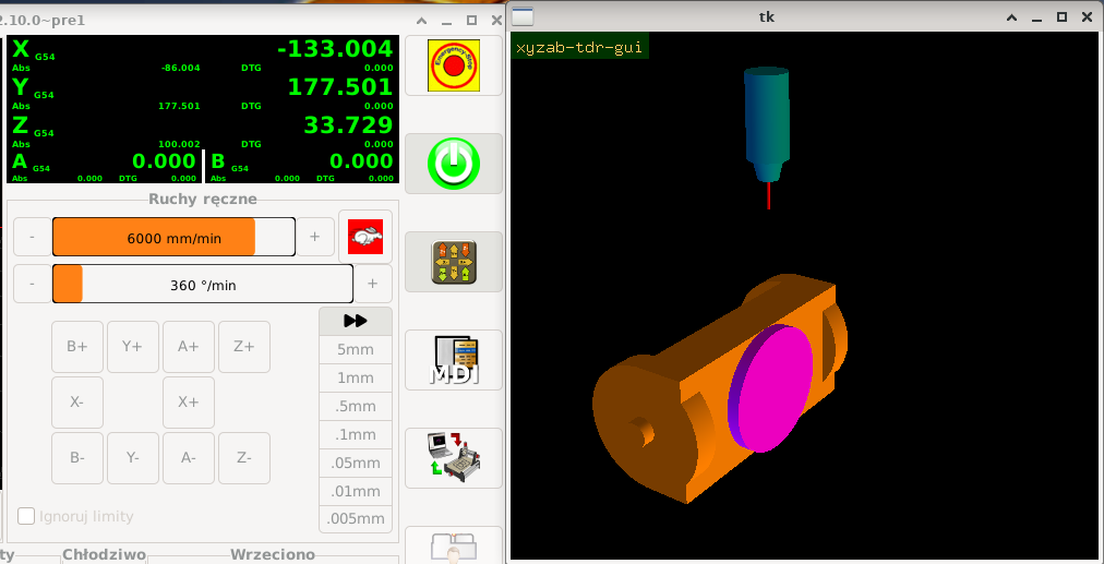

Well, after a 90-degree rotation, G12.1 actually swaps the axes.
This is probably mathematically correct and works correctly in the simulator and on a real machine in JOG mode.
But when I try to use the g-code in MDI or in a program, this converted Z(abs) value is compared to the Z axis soft limits specified in the ini file, which makes absolutely no sense.
As you can see in the pictures, even an attempt to rotate by a very small value (here 1 degree) causes an error, although it is very far from the soft limits of the Z axis. Basically, it's even worse, because G0A1 here is a movement around the Z axis, the spindle is supposed to stay in place, and the error appears...

This is a limitation of the current implementation. See the millturn sim config on how to switch the limits using the 'ini' halpins when switching the kinematics. Note that this workaround is crude and will basically only allow to expand the limits to avoid false soft limit errors.
There is currently major work underway to give linuxcnc proper multi axis capabilities, including proper limits handling. The G12.1/ G13.1 codes are part of this work and many further changes are currently in testing and will hopefully be merged step by step into master over the coming months.
