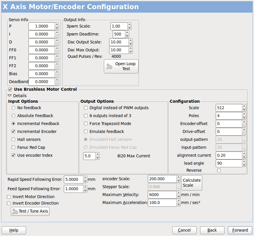

I start a new thread here, as I hope to use pncconf for 7i43 with 2x7i39.
There are new options for brushless motors in pncconf, and there's support for 5i20+7i39. But not for 7i43.

Try this XML file.
- Posts: 7961
- Thank you received: 2162
19 Feb 2012 08:21 #17817
Replied by cmorley on topic Re:7i43 + 7i39
already found a bug. You can't set the 3pwm base frequency.
I pushed the fix.
I pushed the fix.

Thank you, Chris, I tried the xml and got a config.
When I connect the motors I can try it.
I see that something important is missing in HAL for every axis:
# ---TPPWM Generator signals/setup---
# three output 3pwg
# TODO write some commands!
Should it be 3pwmgen here? Maybe something like
setp hm2_7i43.0.3pwmgen.00.scale [AXIS_0]OUTPUT_SCALE
setp hm2_7i43.0.3pwmgen.00.fault-invert 1
net pwm.00-a bldc.0.A-value => hm2_7i43.0.3pwmgen.00.A-value
net pwm.00-b bldc.0.B-value => hm2_7i43.0.3pwmgen.00.B-value
net pwm.00-c bldc.0.C-value => hm2_7i43.0.3pwmgen.00.C-value
I'm so confused with all these signals
Is that correct with setp hm2_7i43.0.3pwmgen.00.fault-invert 1, Peter?
# three output 3pwg

Yes fault_invert should be set
(this is because the fault input is unused (unconnected to an I/O pin)
and by default all unused input pins are terminated at '0' inside the FPGA)
so you want the fault input to be active high.
Otherwise you will have a continuous fault and therefore no PWM out

Hello again,
I already have my linear motors (with no Halls).
And I'm still worried by these lines in generated .hal file
There's new bldc_sine component in 2.5.0, how can I use it?
What should be here?# ---TPPWM Generator signals/setup---
# three output 3pwg
