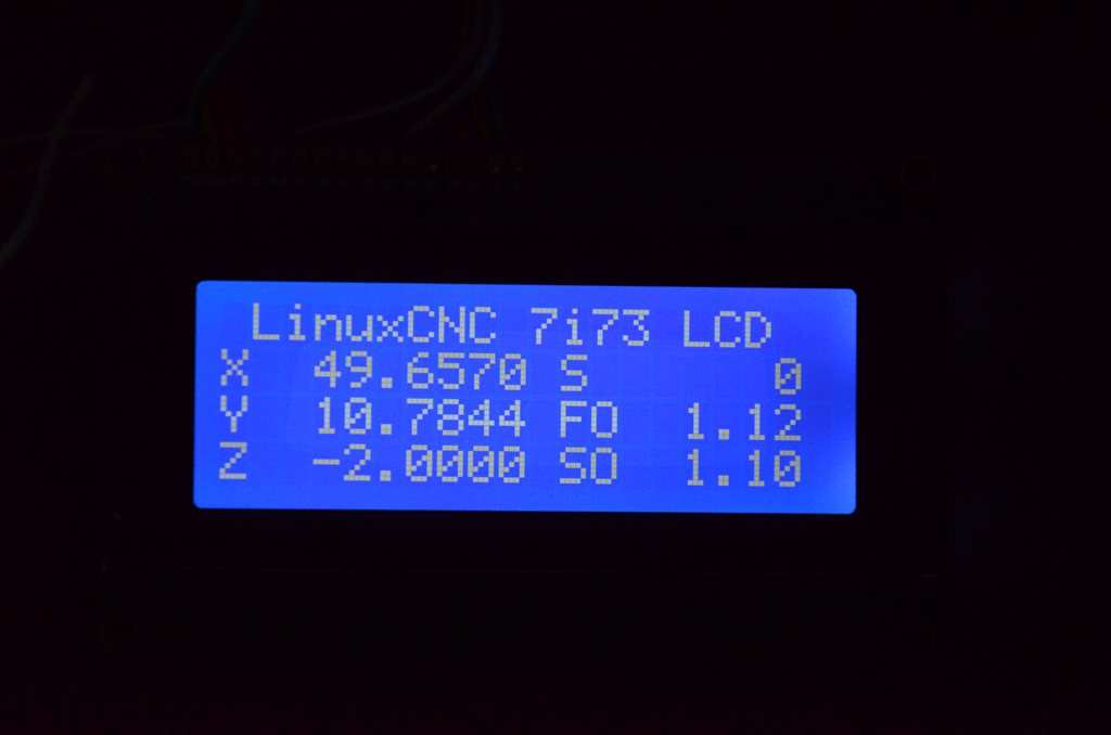

Well, I noticed that \n occupies a digit. That is 01234567890123456789\n gives the first string 01234567890123456789 and the second string is empty.
So I deleted all \n.
But for instance loadrt lcd fmt_strings="01234567890123456789X% 9.4f S% 8.0fY% 9.4f FO% 7.2fZ% 9.4f SO% 7.2f" still blinking
Also, loadrt lcd fmt_strings="0123456789012345678 X% 9.4f S% 7.0f\nY% 9.4f FO% 6.2f\nZ% 9.4f SO% 6.2f" gives X at the last bottom digit out of nowhere. And usual blinking
Much for LCD component because no blinking when machine is turned off.

I am afraid that all I can say is "it worked for me" and I had no blinking:
picasaweb.google.com/lh/photo/fCc5K4YxIL...pFm0?feat=directlink
There is a chance I will have the time an inclination to try your format strings some time to see if they work on my system.

If you want analog inputs you want software mode 1, The LCD component does not support the fast (32 bit) LCD mode selected by software mode 2.
Also what display do you have? If its not 20X4,
the 7I73s EEPROM LCD setting will need to be changed

I already know where the problem is.
I want to use all string lenght so bottom right digit is used too. Then | symbol meant to create the next page also wants to show and it pops in upper left corner and forms an empty string there. That gives first string blinking.
You don't have the problem because the last digits are free (or they contain \n).
Is it possible to change something so that \n and | would not show at all?
PS this is my cheap 2004 display (this was taken when the last digits were free and it did not blink)

I just changed for net lcd-out => hm2_5i25.0.7i73.0.1.display32 and it's ok
Replied by PKM on topic Re:7i73 Pendent Control
I had already read that somewhere here... so I was surprised that it works somehow.If you want analog inputs you want software mode 1, The LCD component does not support the fast (32 bit) LCD mode selected by software mode 2.

I guess it might work since there will only be one 8 bit character in the 32 bit data and the other bytes will be nulls which are ignored.
You will not get the faster update rate since the LCD comp will only send a character at a time instead of 4 however.
