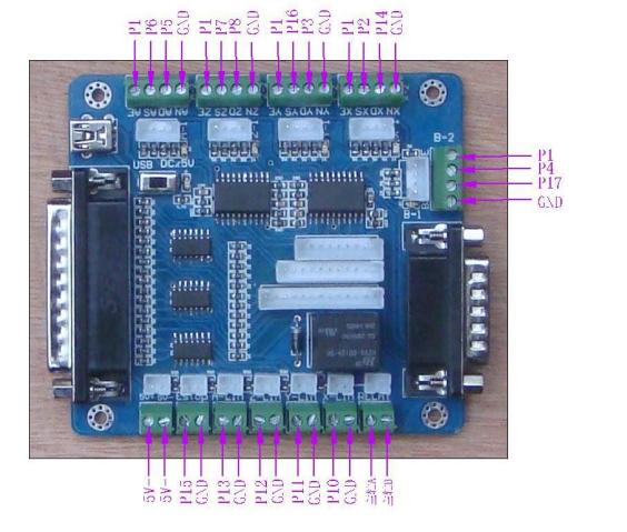

Excuse me PCW, I had not understood you, with Mach 5 axis you mean something like the attached image. This creates a series of doubts for me:
1-Obviously if the DB25 I have busy with the 7i76, that BB should connect it to the extension port of the 5i25.
2-The configuration of the INI and HAL to be able to conduct the laser.
3-If I can wire the BB and drive the laser, could I also use the rest of the outputs as additional axes?
Thank you very much, this could open me a wide range of possibilities.
- Posts: 18115
- Thank you received: 5334
29 Nov 2021 18:34 #227935
Replied by PCW on topic TTL (PWM) Laser head and Mesa 7i76
Yes, that kind of a breakout can be used on the 5I25s other connector.
It would need custom firmware to put at least one PWM generator on
the one or the breakout boards step/dir outputs (the spare outputs
can be more step/dir axis)
I can make this firmware if you indicate the breakout type you choose.

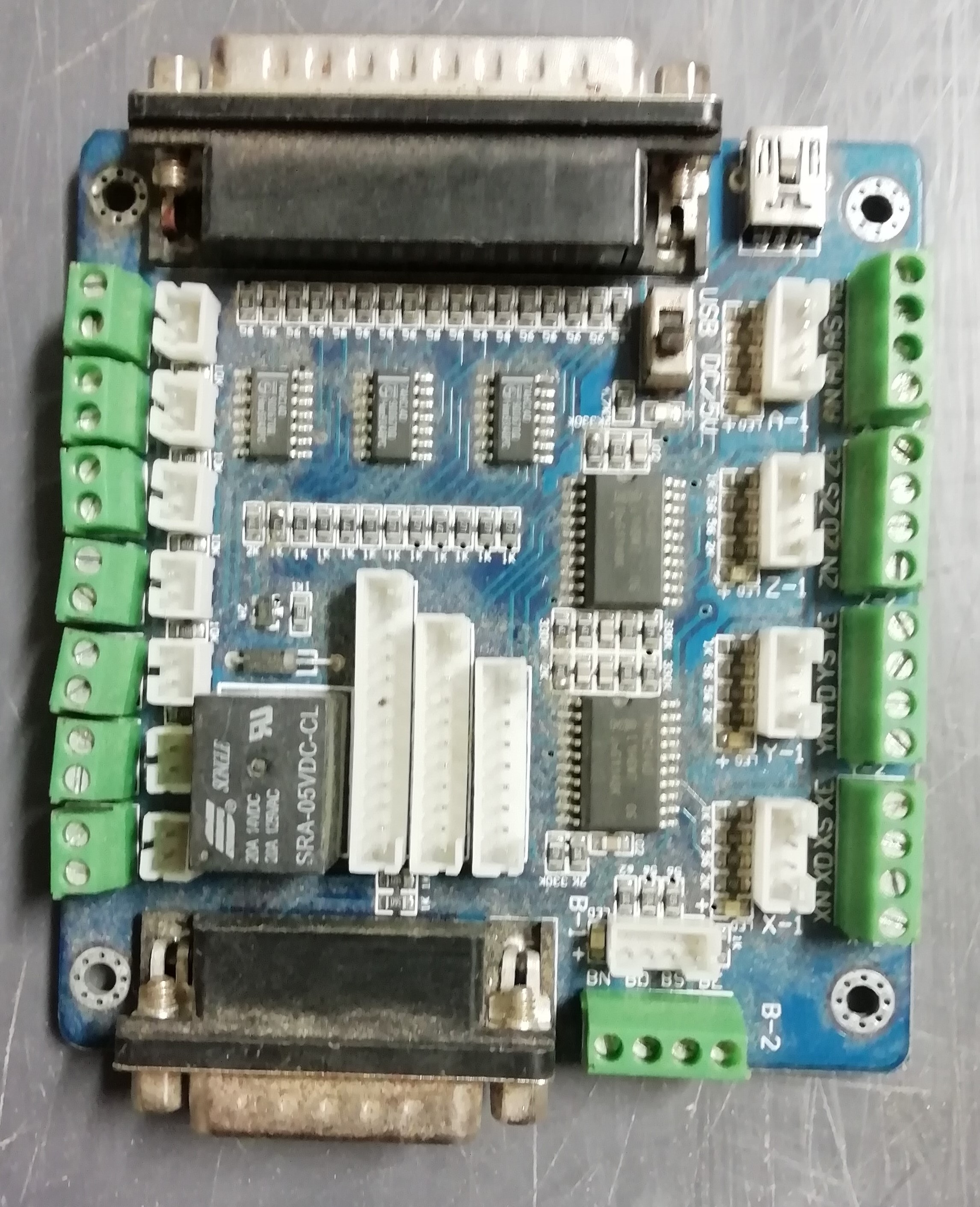

29 Nov 2021 18:48 - 29 Nov 2021 18:53 #227936
by RoberCNC
Replied by RoberCNC on topic TTL (PWM) Laser head and Mesa 7i76
Last edit: 29 Nov 2021 18:53 by RoberCNC.
- Posts: 18115
29 Nov 2021 20:40 #227943
do you have a pinout diagram of that one?

30 Nov 2021 11:15 - 30 Nov 2021 11:17 #227991
by RoberCNC
If the info I´ve found is ok the pinout is as follow:
1-Enable
2-X step
3-Y dir
4-B step
5-A dir
6-A step
7-Z step
8-Z dir
9-Spindle
10-X limit
11-Y limit
12-Z limit
13-A limit
14-X dir
15-Input (E-stop)
16-Y step
17-B dir
18 to 25-Ground
