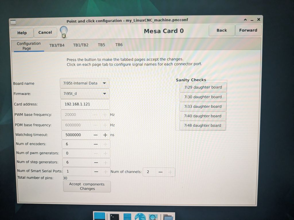

Unfortunately, I don't have the 7i95T board assembled yet - I'm waiting for some parts - only the servo is provisionally connected. If I create a simple x-configuration in Config Tool 2, I can move the servo.

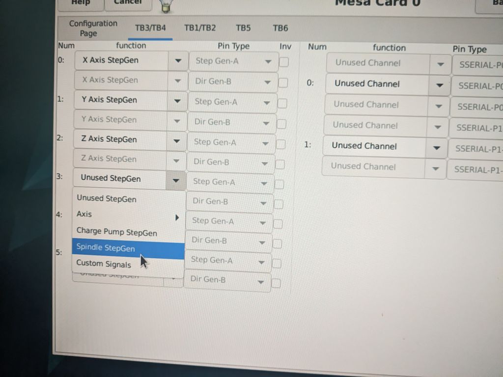

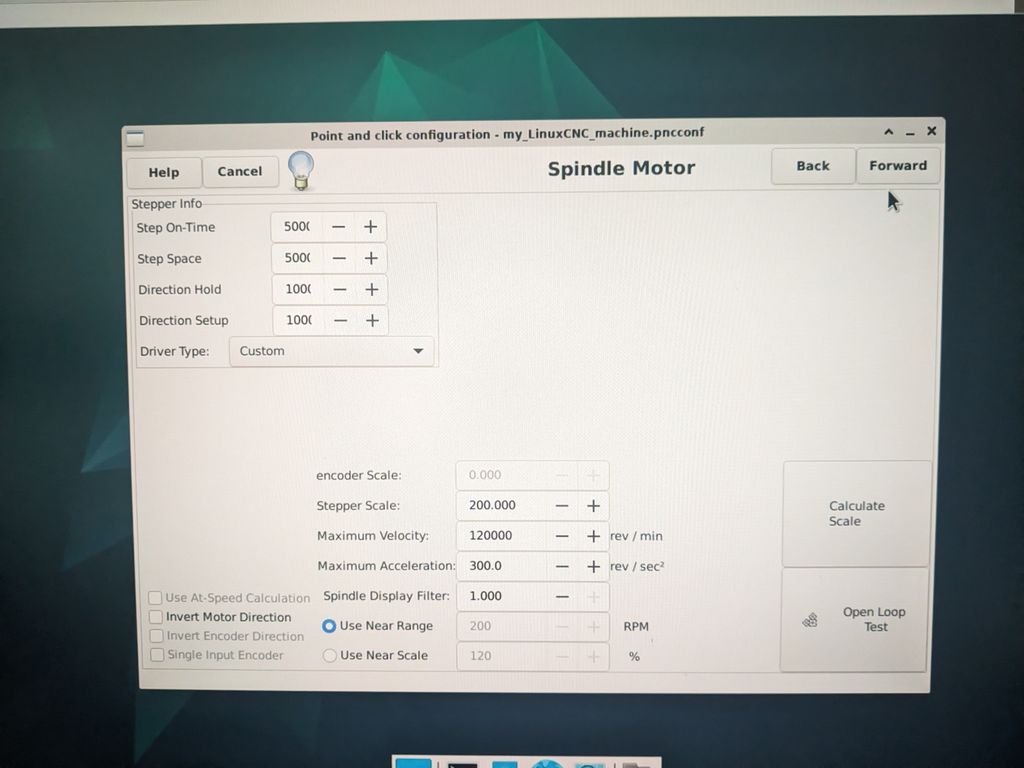

after editing the PNCCONF according to kworm - update
forum.linuxcnc.org/39-pncconf/56464-mesa...thcad-pncconf-screen
is possible to configure the step-dir spindle in 7i95T
