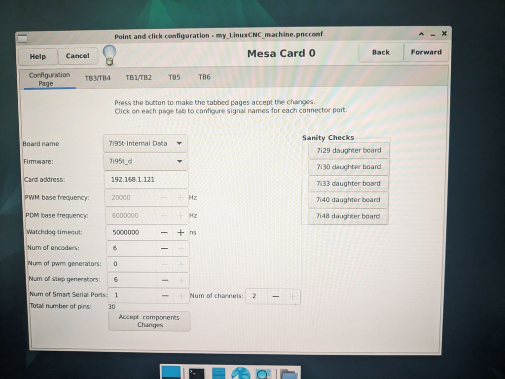

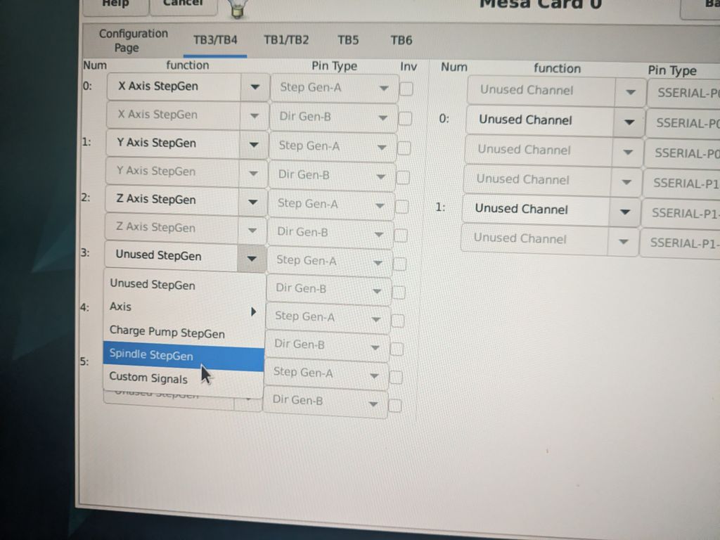

I added support for the Mesa 7i95t to the pncconf wizard (private_data.py with changes attached) and it seems to work ok other than needing to rename the inm to inmux pins for the 7i95t. However, the THCAD configuration screen doesn't appear even though I assign an encoder input to arc voltage. I must be missing something in looking at the code but I don't find where self.d._arcvpin that is used to control the display of the THCAD screen is ever set to anything other than None. I have QTPlasmaC selected as the gui. Any help is appreciated.
Solved: Attached updated files with the THCAD tab working. The pages.py and private_data.py go in /usr/lib/python3/dist-packages/pncconf and the pncconf.txt should be renamed to /usr/bin/pncconf.
