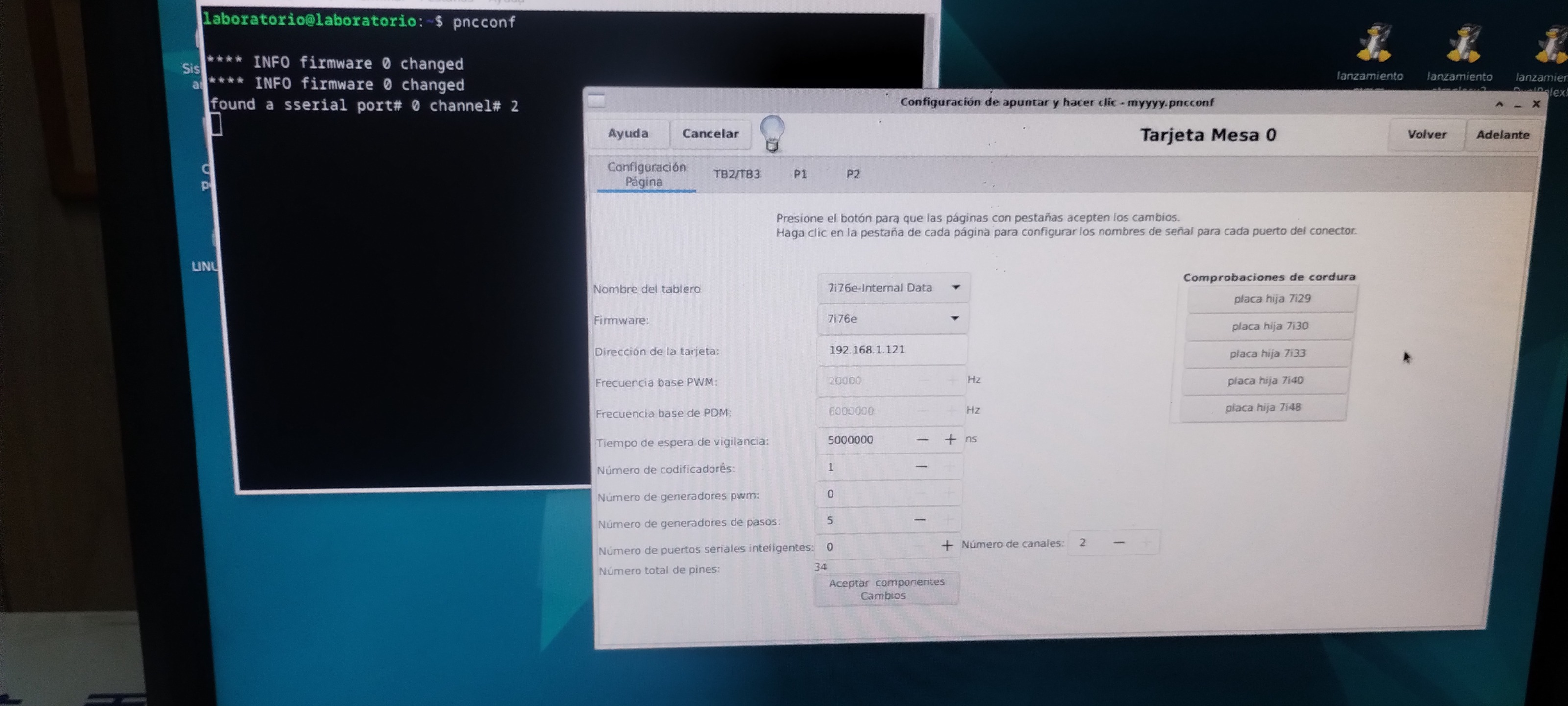

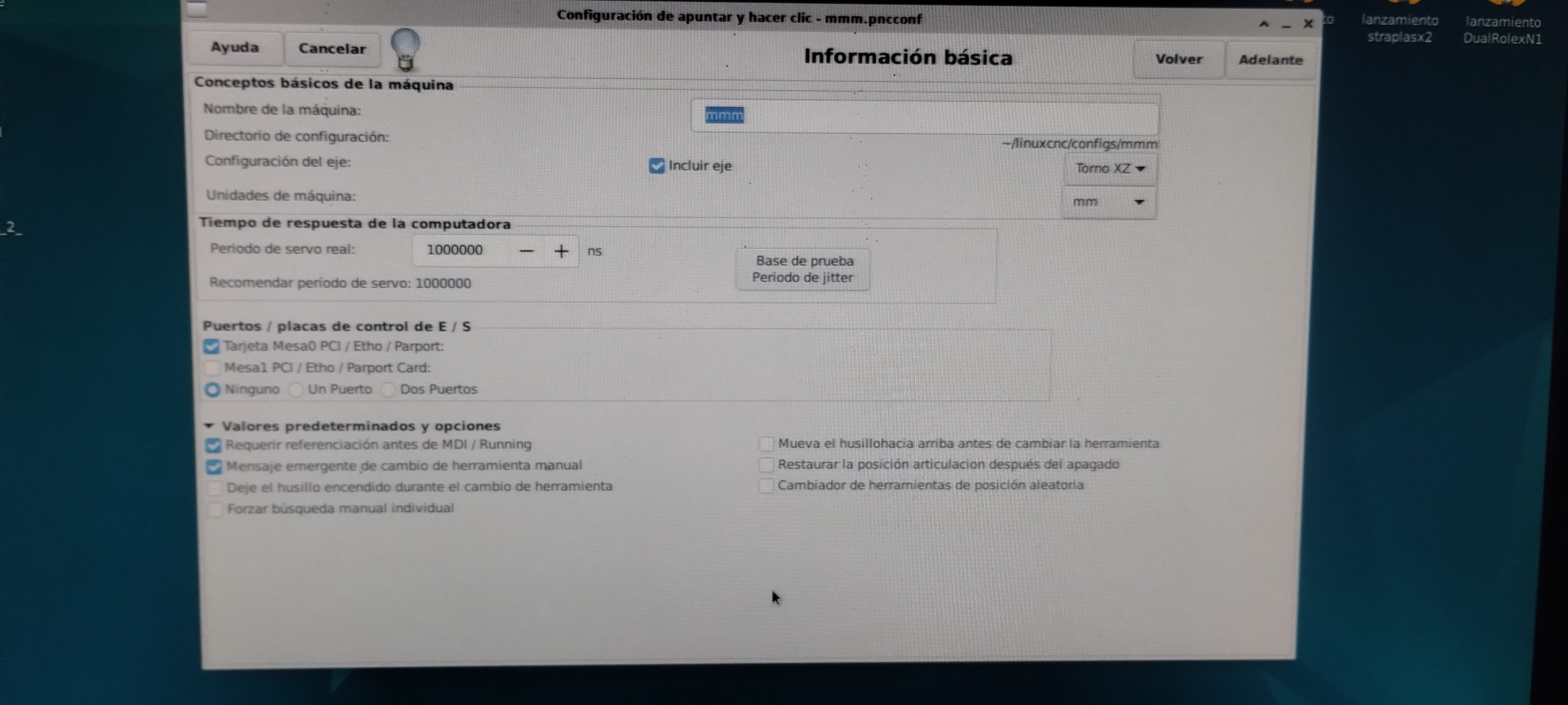

I can't configure the spindle, the configuration screen doesn't appear.
also can't choose the PWM signal or CW - CCW.
I am on 2.9.5 and I don't understand what I'm doing wrong.
There is something that changed, in version 2.7.15 of LinuxCNC it could be done without problems, now it is impossible for me, I don't understand what is happening, I can't find information to guide me. Thank you.!!!

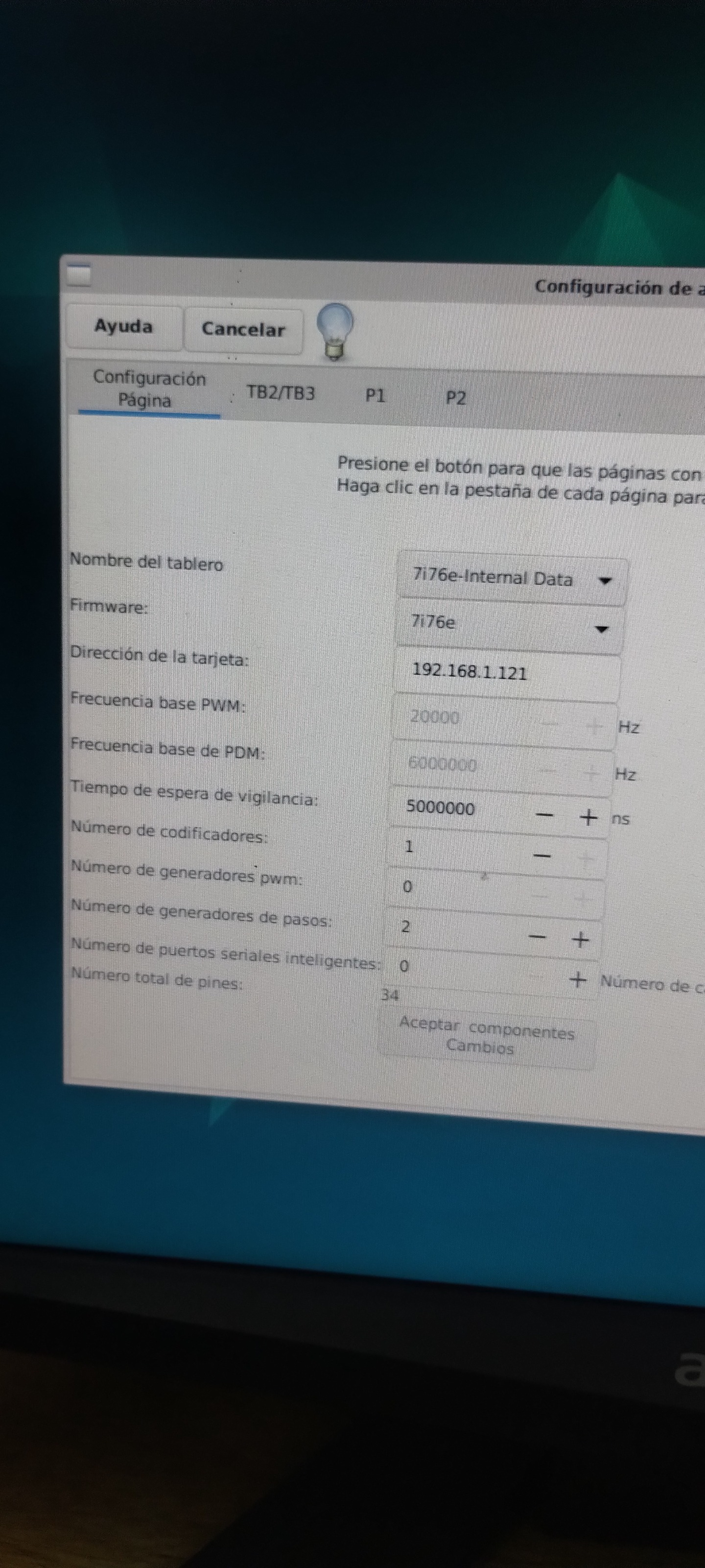

I can't see that page, it goes up to P1-P2.
I see only TB2/TB3 P1 P2
it doesn't allow me to add a PWM. I set it to 1 and it goes back to 0

Replied by PCW on topic 7i76E Spindle configuration
I suspect this may be a localization bug in pncconf
If you run pncconf from the command line, does it print any error messages?

I can run it from the console without any problem.
Can the network configuration affect?
No, the FPGA card need not even be present for pncconf to run
I would try setting the locale to en-US

Could someone set up a 4 axis + 1 spindle of 24000 rpm with pncconf?
I assembled 2 computers with 2 7i76e motherboard boards and both are experiencing the same issue.
I can program manually with cw cww enable and it works perfectly, but when I want to incorporate a pwm component, it gives me an error.
If I can obtain the .hal and .ini files, I can modify them and proceed with a machine that I need to get working.
thank you!!!!!!
thank you!!!!!!

Here's a pncconf created basic 4 axis configuration with spindle:
The following user(s) said Thank You: RobotMatic

Thank you very much!!!!!
