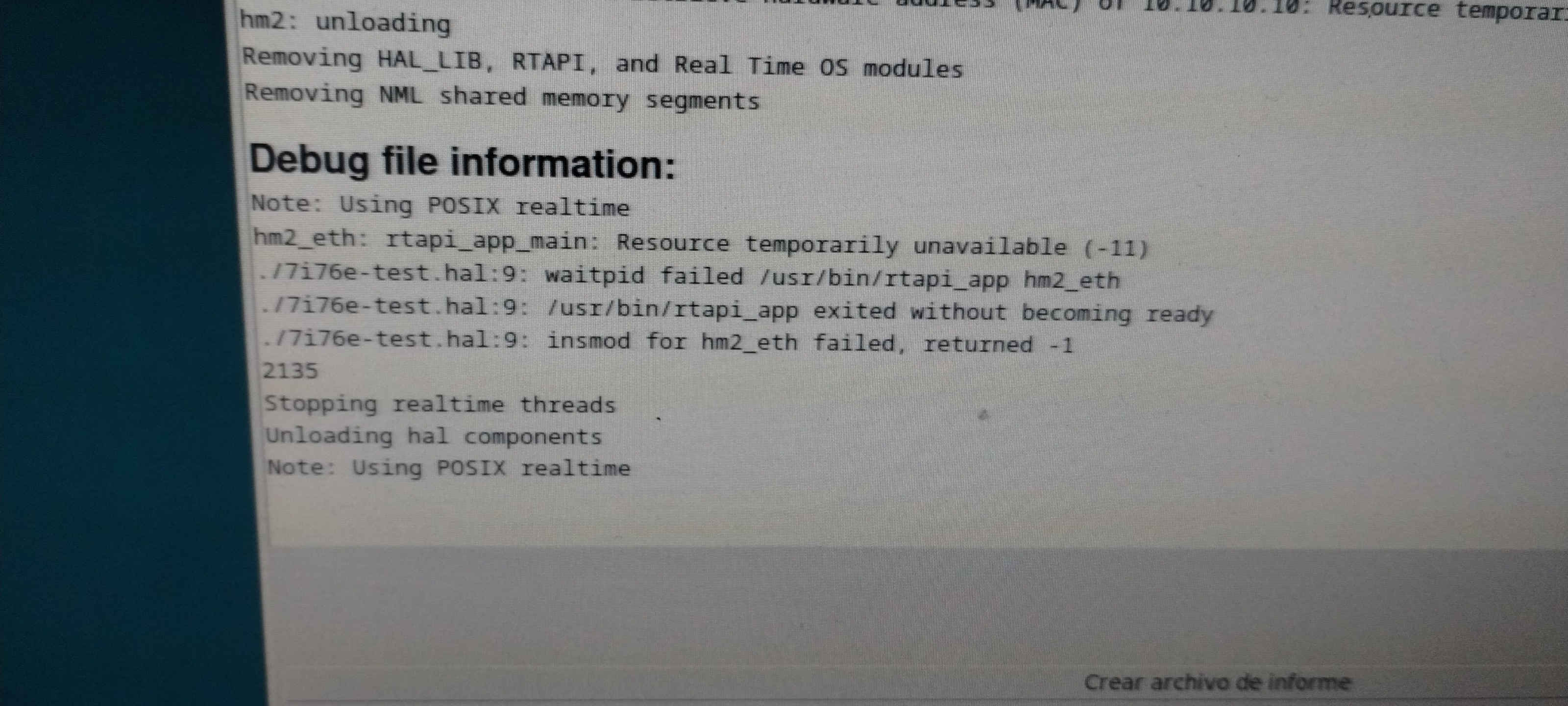

Houston !!! i have a problem!!!

16 Sep 2025 23:11 #335095 by tommylight
Replied by tommylight on topic 7i76E Spindle configuration
Is the networking set up for Mesa?
Is the IP address on the board set same as in the config?
The following user(s) said Thank You: RobotMatic
16 Sep 2025 23:19 #335096 by PCW
Replied by PCW on topic 7i76E Spindle configuration
Yes, the sample file is set for a 10.10.10.10 IP address
if you are using 192.168.1.121, you will get that error

17 Sep 2025 03:25 #335108 by RobotMatic
Replied by RobotMatic on topic 7i76E Spindle configuration
I was able to correct the IP address
it doesn't work, I can set cw-cww-enable but no speed.
I am trying to update and it cannot find the linuxcnc repository , gives an error
I am using 2.9.5
Should I reinstall everything again?
I don't understand what is happening
