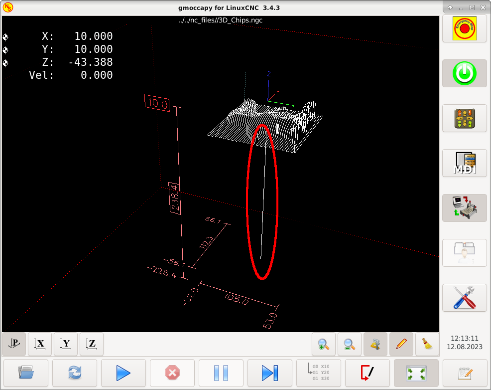

- zz912
- Posts: 596
- Thank you received: 98
10 Aug 2023 04:51 #277504
by zz912
Is there a clean fix in version 2.9?
I have the same problem.
I am getting spindle movement during ATC. I don't see the movements for machining.
I experimented with:
(PREVIEW, hide) and (PREVIEW, show) in g-code
but all I got was nothing showing up in the preview.
Zdenek
Replied by zz912 on topic Gcode preview and remap
Hello Norbert,Hallo,
a very dirty fix would be to add a test to /linuxcnc/lib/gladevcp/hal_sourceview.py at line 81, after the line
fn = self.filename
if fn.split(os.sep)[-1] == "change.ngc": return Then the gcode window will not be filled with the remaped code, if it is called change.ngc The problem is caused IMHO, due to the reason, that the remap emits a file changed signal, but when it ends, there is not emmited the signal again from the running main program. It would be possible to exclude also any program, beginning with "remap_", so it would be possible to exclude all remap stuff. What do the reals developers think about excluding files to be displayed? I tested that with gmoccapy_tool_sensor.ini On the other way, the test for remaped code could be done in hal-glib / GStat. Does someone know if a remaped state signal is set during remap? Norbert
Zdenek

12 Aug 2023 10:15 #277718
by zz912
A similar bug can be easily simulated.
Use this procedure:
github.com/LinuxCNC/linuxcnc/issues/2448
End at point 6.
Then open the file 3D_chips.ngc.
That line below the penguin is the ATC trajectory.
In this simulation, preview behaves a little differently to me than in a real machine. Anyway, I think the behavior is weird.
Use this procedure:
End at point 6.
