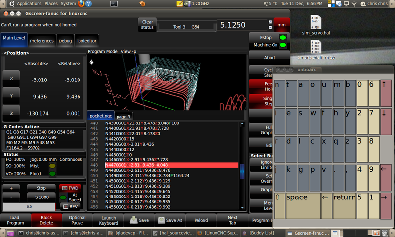

The blue lettering in the progrham area is really hard to read. Perhaps a different shade or different color. What is the play,pause and skip buttons for? Estop should be red not green and machine on should be green not red.

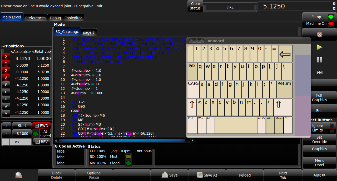

I have keyboard so it pop open and closed. I still need to change the layout and colors.
The DRO is for Fanuc style not sure if thats an improvement or not.
I'm thinking I could put the G and M code as a vertical list under the DRO - again more Fanuc style.
I see I could spend a lot of time making screens for people

Yes the blue lettering Is the choice of the Gcode text editor and I agree it's hard to read.
I haven't looked at how to change that but the background can be changed in the theme.
Themes are another deep well to dig into. They change the look and feel of the widgets.
They are very powerful but of course that means they are a lot to learn.
That particular theme is one I modified for red buttons. I just never finished it.
The play pause etc are icons for running the program, I have since changed them to regular text. cycle start. abort,feed hold, and single step
In that pic the Estop button was not connected - when connected, is Estop is clear it's green and when machine is on it's green otherwise it's red.
I could have the LEDs be dark or they could blink when estopped... the text could change - in fact the machine on changes to machine off.
I tried the blicking LED - I like that.

Not much has changed. I can change the layout/color of the onboard screen but haven't got it to embed inside the main screen - It may be easier to just let it pop on top (there is a button to launch/hide it.)
The LED blinks on estop - really gets your attention.
Text instead of some of the icons.
This is a custom screen the stock Gscreen has not changed in awhile.
I think it's to the point where someone needs to use it and find what works and what doesn't.
I am working on adding more options for real controls which is proving to be a bit of a pain deciding how.
What controls do most of your machine have or more importantly wanted.
