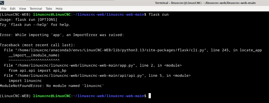

- magyariadam
- Posts: 2
04 May 2025 09:25 - 04 May 2025 11:25 #327663
by magyariadam
Replied by magyariadam on topic web interface
Last edit: 04 May 2025 11:25 by magyariadam.
- meister
- Posts: 806
- Thank you received: 502
05 May 2025 05:57 #327737
by meister
Replied by meister on topic web interface
it must run on the same computer as linuxcnc, to find the python libs.
BUT, it's only a proof of concept, do not use it for production systems
