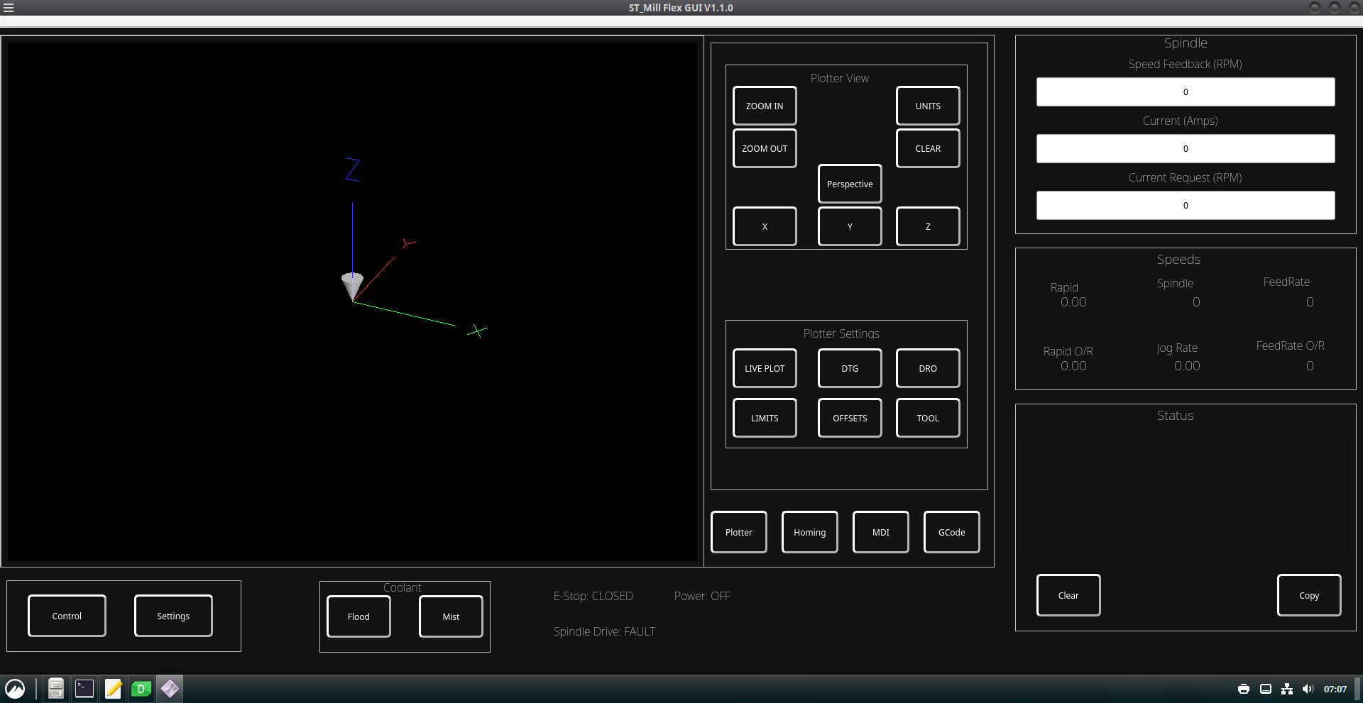

If anyone wants to look at the flexible GUI I'm working on it's
here
and the terse docs are
here.
The idea is to allow users to build a GUI to fit their needs and not be forced to use some predefined GUI. There are some minimal items required, the rest are "discovered" and if there "connected" to the functions. The way this works is you have to name the buttons, labels etc with specific names. They can be placed anywhere you like in the gui. You can use built in stylesheets or use your own. I will probably rename this to Flex in the near future, but for now it's JET cause that's me. You can also use the stock ui file that I'm working with. So pretty flexible!
This is created with PyQt6 and Python 3 so it's future proofed for a few years unlike older GUI's.

07 Feb 2024 16:36 #292756
by blazini36
Replied by blazini36 on topic Flexible GUI
What is the "Plot" tab? is that supposed to be Gremlin? Didn't seem to show anything when I ran the example.
- JT
- Online
- Posts: 1050
- Thank you received: 542
07 Feb 2024 17:17 #292761
by JT
JT
Replied by JT on topic Flexible GUI
No it's not gremlin, it's a brand new plotter based on PyQt6 and OpenGL... just not done yet. Everything in Flex GUI is based on the latest tools so it will last a long time I hope.What is the "Plot" tab? is that supposed to be Gremlin? Didn't seem to show anything when I ran the example.
