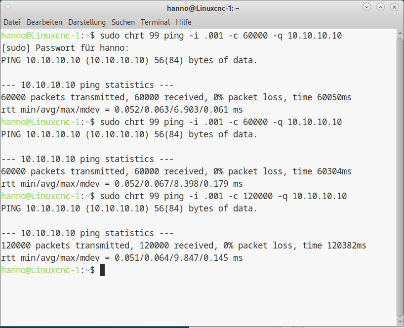

20 Feb 2025 21:13 #322112
Replied by PCW on topic motor-0-position error beim Abbremsen aus 4-7,5 m/min
Ideally you should get no dropped packets at all.
I does sound like a network latency issue.
One thing to do to test is to run say:
sudo chrt 99 ping -i .001 -c 60000 -q 10.10.10.10
(will run for ~1 minute)
and see what the stats are
If there are no more network latency optimizations to do
You can increase the servo thread period (say to 2 ms)
Its also possible to make dropped packets not trigger following errors
(or cause path deviations) by specific hal file modifications

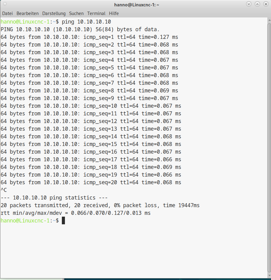

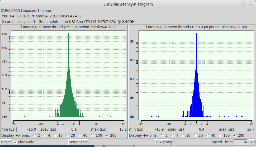

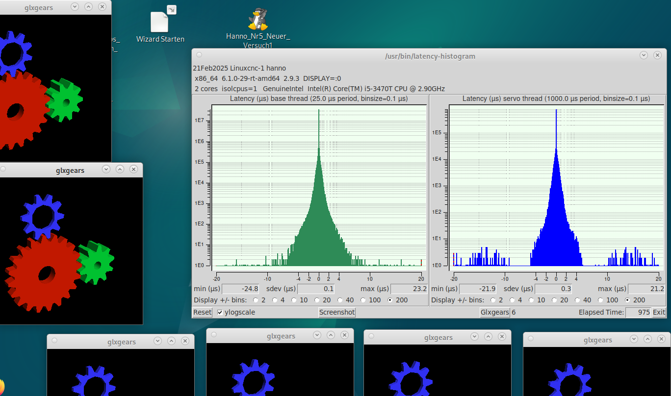

21 Feb 2025 12:58 #322200
by Muftijaja
Replied by Muftijaja on topic motor-0-position error beim Abbremsen aus 4-7,5 m/min
Hello PCW! Thanks for your hints yesterday.
I did some pings and latency histograms, I hope I can put the photos in here. I thought both was allright, but this motor-0-position errors (and "error-finishing-read" at start) seems to be persistent.
BTW, I tried the most of this thread: forum.linuxcnc.org/38-general-linuxcnc-q...ead-and-irq-affinity and it was very successful in this regard, except these errors.
I think I try servo thread with 2 ms.
Thank you for your support!
Hanno

21 Feb 2025 14:57 #322205
The ping test shows the issue with nearly 10 ms delays some times.
If you have a Realtek Ethernet interface it may require replacing
the stock driver with the DKMS one.
You can usually determine the Ethernet MAC on the PC with:
lspci | grep -i ether
